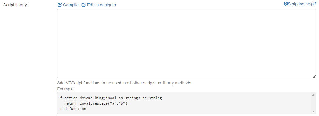

To access and use the Script Library, follow these steps:
- Go to Content > Content > <content source name> and click the Advanced tab.
- Script Library:
- Scroll down to and write your custom function, which uses any standard. VB.NET function, here.
- The output of the script is determined by your final return statement.
- This output can be in the form of integers, DateTime, string, string array, or any other VB.NET type.
- Compile:
- Click to validate your function.
- Perform this operation for each function that you add.
- Save: Click to add this function to the library.
