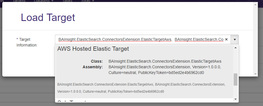

- The Load Target dialogue appears. Select the following target from the drop-down menu:

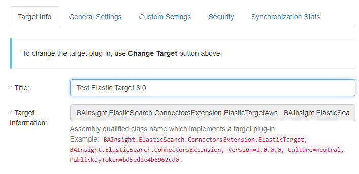

- Select the Target Info tab. Enter the following information:
- Title (required): Specify a name.
- Target Information: (required): This field is pre-populated: BAInsight.ElasticSearch.ConnectorsExtension.ElasticTarget.

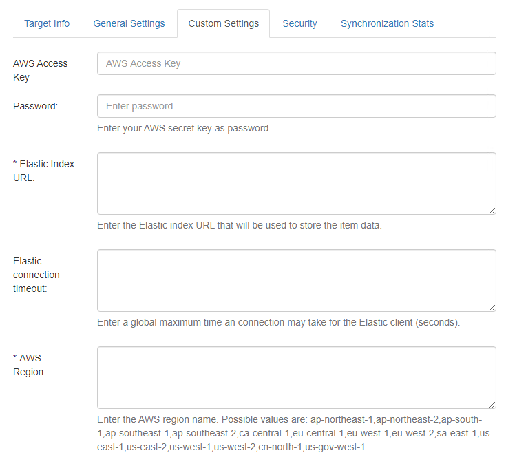

Select the Custom Settings tab.
- AWS Access Key:
- Password:
Elastic index URL (required): Enter your URL in the format:
http(s)://[server_name]:[port_number].
Connectivity Hub attempts to connect to the index using this address [index_name].
If the index does not exist, Connectivity Hub creates it.The Elastic Schema will be created automatically.
AWS Region

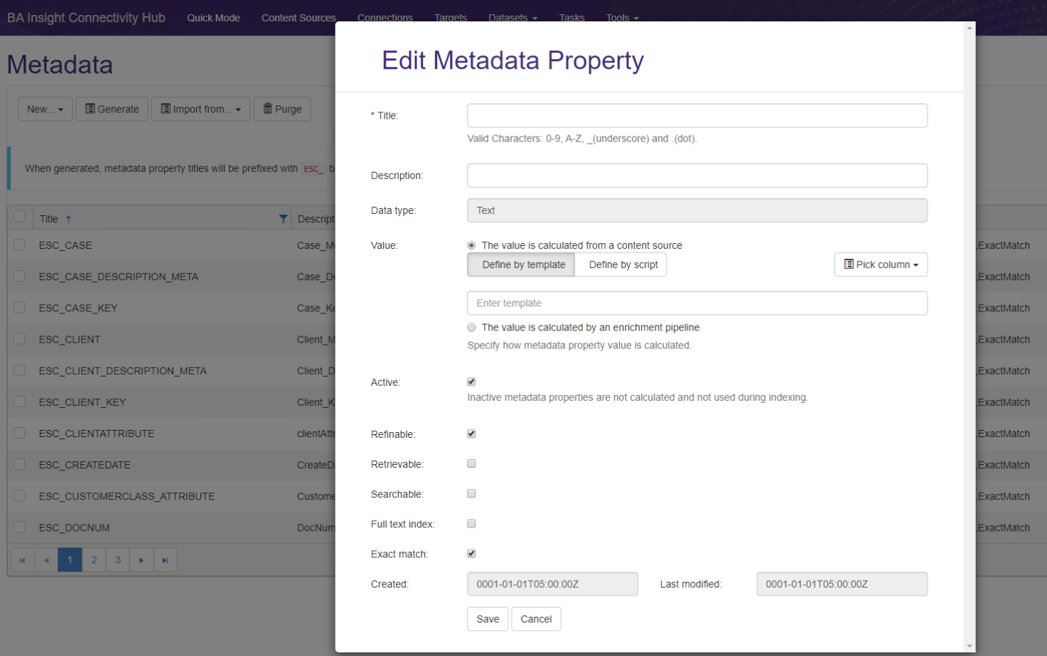

To define the fields you want to see in your index use the Metadata page and set the Active, Refinable, Searchable, Exact match settings for your metadata.
The fields will be automatically created in your index, based on these settings.

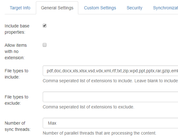

- Click Include base properties to make the system metadata emitted by Connectivity Hub accessible to the Elasticsearch target.

Use the metadata page and mark the properties as Inactive:
How to Group All Non-refinable/Non-searchable Properties
You can group all non-refinable/non-searchable properties from ConnectivityHub into a bulk property in Elastic by setting the Active and Full text index property on your metadata:
After indexing, all values are found under the escbase_fulltextcontent property.

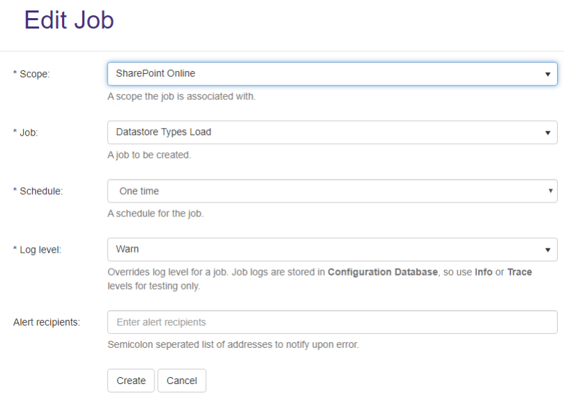

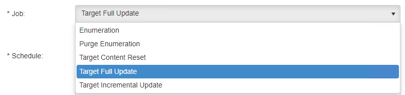

To run a "Full Target Update" job, follow these steps:
- Go to the ConnectivityHub Tasks page.
- Click New and the Edit Job page appears.

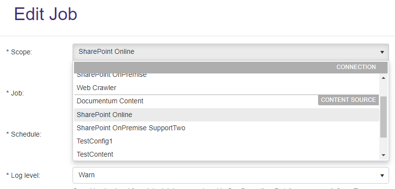

- In the Scope drop-down list select the Amazon Elasticsearch content source (not shown in graphic) to run your job against.
Select Target Full Update from the Job drop-down list.
- Complete the remaining fields.
Click Create.
