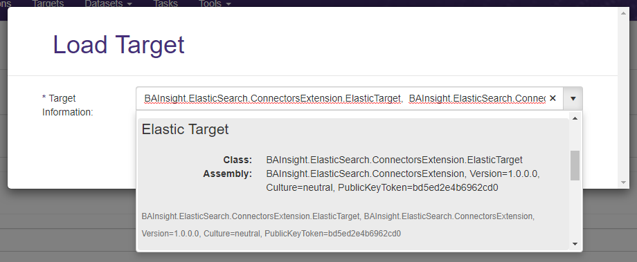

- Select New>Target.
- The Load Target page appears.
- Select the generic Elastic Target.

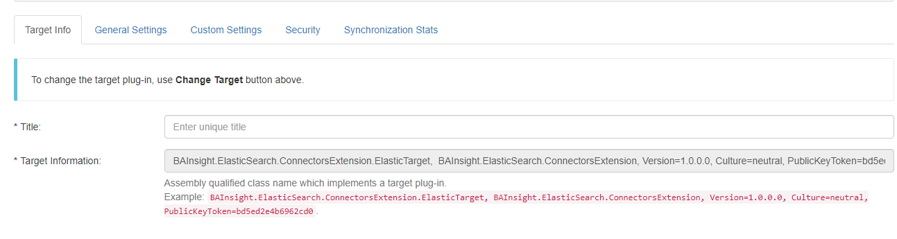

- Select the Target Info tab. Enter the following information:
- Title (required): Specify a name.
- Target Information (required): Autopopulates. Enter BAInsight.ElasticSearch.ConnectorsExtension.ElasticTarget.

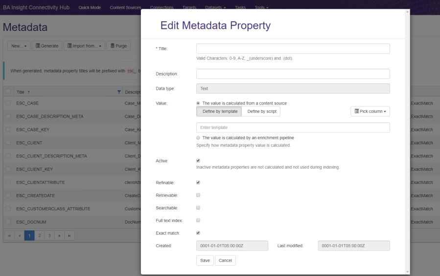

- To define thefields you want to see in your index use the Metadata page and set the Active, Refinable, Searchable, and Exact match settings for your metadata.
The fields are automatically created in your index, based on these settings.
- If you need to query against the specific property, mark it as Active and Seachable
- If you need to use the property as a refiner mark it as Active and refinable
- If you only care about the value of the property and only need to query againt the content of the property, then mark is Active and Full text indexable

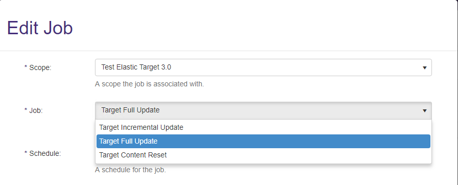

To run a Full Target Update job, follow these steps:

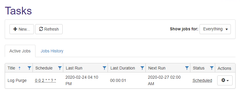

- Go to the ConnectivityHub Tasks page.

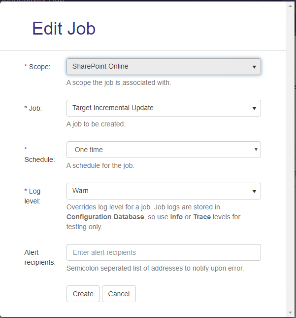

- Click New and the Edit Job page appears.

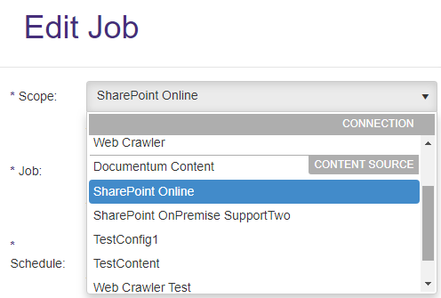

- In the Scope drop-down field, select the Content Source for which to run the full target update.
- Select Target Full Update from the Job drop-down list.
Click Create.
