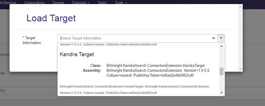

- Go to the Connectivity Hub Target page.
- Select New>Custom API Target.
- The Load Targetdialog appears.
- Select Kendraas the target from the drop-down menu. Scroll down if you do not see your target.

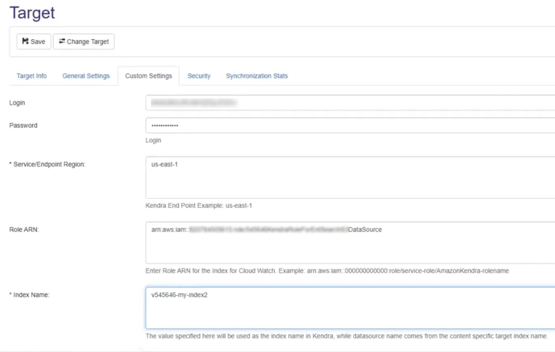

Select the Custom Settings tab.
Login: Enter an AWS Access Key.
Password: Enter the AWS Access key secret

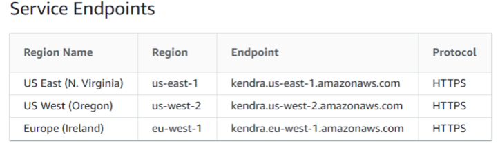

- Service/End Point Region: Enter a Kendra Service Endpoint Region
Role ARN:
Optional (see screenshot above)
Enter a Role ARN (Amazon Resource Name) with either of the following:
Admin access
Permissions listed below:

Amazon Kendra requires permissions to access your CloudWatch log.
Choose an existing IAM role with the correct permissions.
Info
Kendra SDK requires a role ARN (Amazon Resource Name) for CloudWatch: it requires permission to write logs to CloudWatch when it interacts with Amazon Kendra.
The role ARN is used to authenticate and authorize the SDK to access the CloudWatch service on your behalf
If you do not provide a role ARN for CloudWatch when using the Kendra Target, then your application cannot write logs to CloudWatch
This means no access to the detailed logs and metrics that can help you troubleshoot issues
Without CloudWatch logs, it may be more difficult to identify and diagnose errors that occur during the Kendra processes

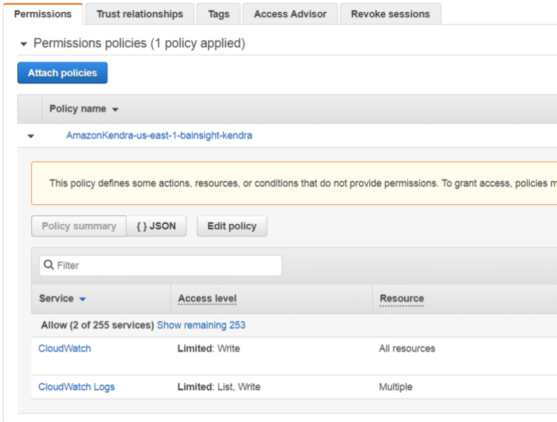

If you do not have an existing Role that has List and Write access to CloudWatch, create a new role in the AWS IAM Console
See the screenshot below:
