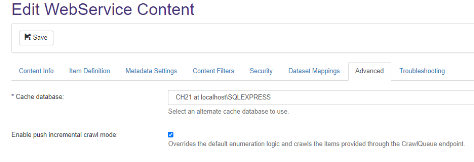

Push incremental crawl mode enables you to override the default enumeration process for incremental crawl and configure Connectivity Hub to crawl the items and folders feed via the CrawlQueue API.
  • This option is useful if you need to achieve near-real time incremental crawl and you have the means to provide the items that must be re-crawled to keep the index fresh.
    • For example, for SharePoint Online you can leverage remote event receiver to identify the items to be crawled and submit those sites, lists, items to Connectivity Hub for processing.
  • When "push incremental crawl mode" is enabled for your content source, the standard incremental crawl logic from the connector is disabled and never used.
Push incremental crawl processes:
  • Items submitted via the CrawlQueue API
  • Any items that registered warnings in the previous run
  • Any folders that failed to be enumerated in the previous run
  • Any datastore that was modified after the previous run

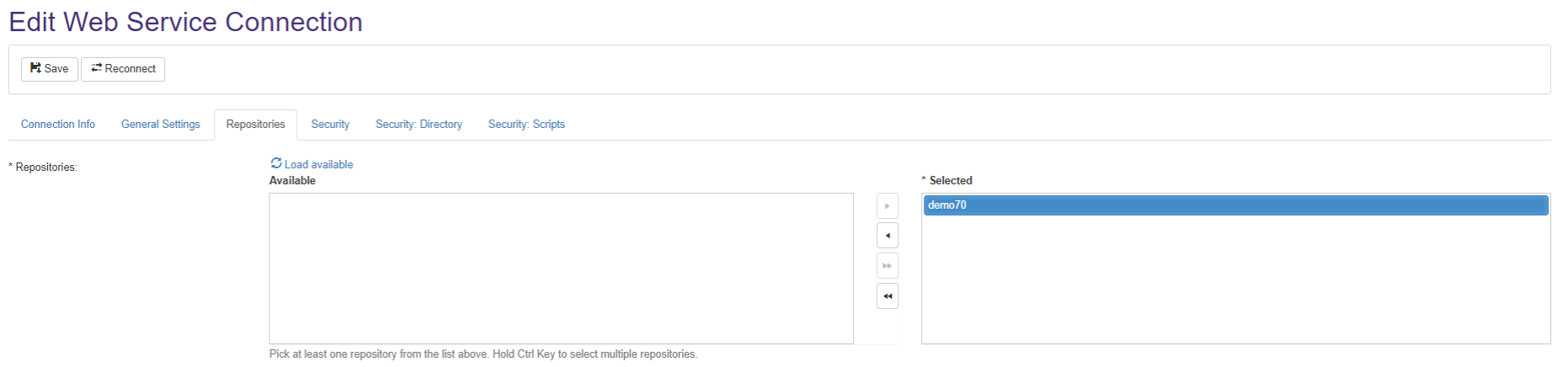

Note: Repository change requires full crawl.
If you edit the connection and change the selected repository list, then a full crawl is required.
Push incremental crawl mode cannot detect this type of change.
