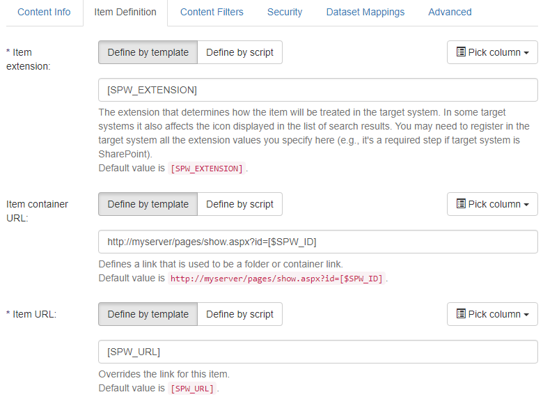

- Navigate to the Content Sources page and click <your Web Service Connector>
> Edit. - Click the Item Definition tab. Fill in the following fields:
- Item extension:
- Define by template: These settings are the default settings and are shown below.
- Define byscript: Enter a script using Scripts page.

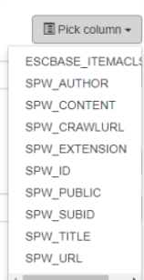

- Pick column: Click to select a database column.
See the following example of possible selections (this varies according to your selection):
- Extension field: (required if the target system is SharePoint): By default,
[SPW_EXTENSION]is entered.- This is the file extension that is pulled from the content repository (the brackets
[]indicate the repository location). - This extension determines how the item is treated in the target system.
- In some target systems this specification also affects the icon that is displayed in the list of search results.
- You might need to register all the extension values in the target system that you specify here.
- Item container URL: Defines a link that is used as a folder or container link.
The default value is[SPW_CONTAINER].
Item URL: Override the link for this item.
The default value is[SPW_URL].-

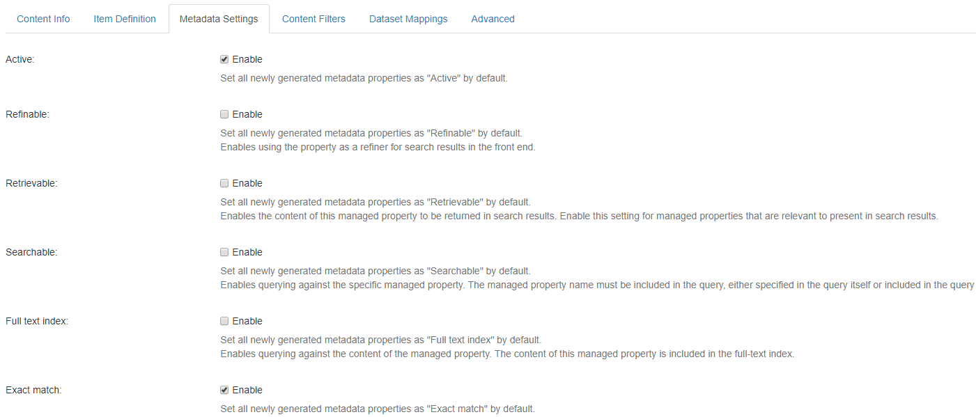

- Use the Metadata settings tab to define the default settings for the metadata that will be generated:
- Click Save if you make any changes.
