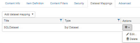

  1. Content Sources > <your Web Service Connector>See the gear icon. > Edit > Dataset Mappings: See the Dataset Mappings page.
    See the Dataset Mappings page example.

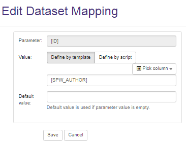

  2. Add dataset mappings:
    See the Edit Dataset Mapping pop-up window.
  3. Parameter: Enter, or leave the default [ID].
  4. Value
    1. template: These settings are the default settings and are shown below
    2. script: Enter a script using Scripts page.
  5. Pick column: Click and select a database column. See the following example of possible selections.
    See the Pick column example.
  6. Default value: Enter a value, such as 0, that will be used if no value is found.

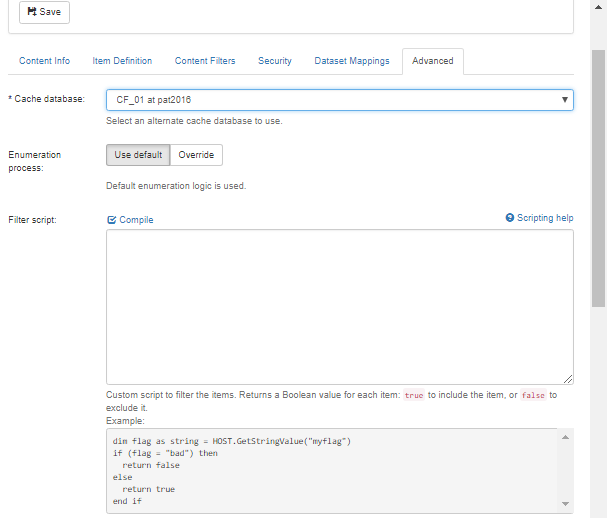

  1. Content Sources > <your Web Service Connector>See the gear icon. > Edit > Advanced: See the Advanced page.
    See the Cache database, Enumeration process, and the Filter script settings.
  2. Cache database:
    1. Required
    2. Leave the default selection (the cache database that you specified during the install operation), or use the drop-down list box to select a different cache database.

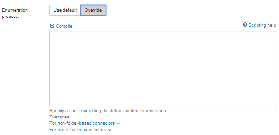

  3. Enumeration process:
    1. Leave the Use default selection.
    2. Alternatively, click Override and specify a script that overrides the default content enumeration.
    3. Using the examples provided for non-folder-based or the folder-based connectors.
      See the scripting box for the Enumeration process.

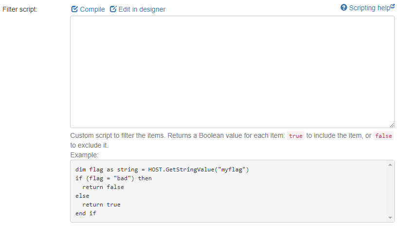

  4. Filter script: Write a custom script to filter database items.
    1. For example, if the item cannot be returned, false is returned and the value is excluded.

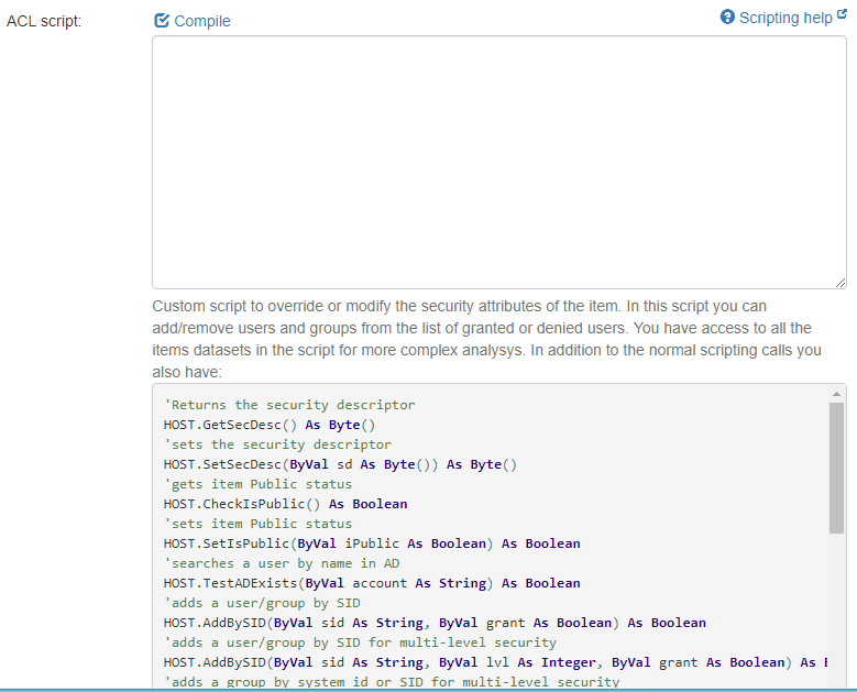

  5. ACL script: Write a custom script to override or to modify the item's security.
    1. You can choose to add, or to remove, users or groups from the list of users who are either granted or denied access.
    2. For more complex analysis, access any of the item datasets in the scripting example that is shown in the UI.

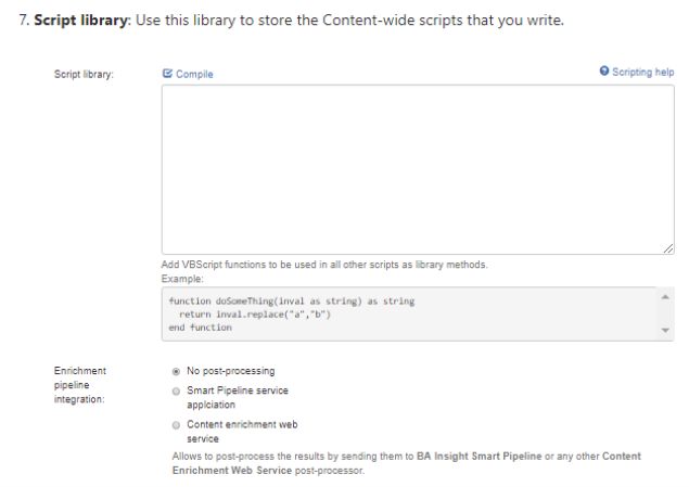

  6. Script library: Use this library to store the Content-wide scripts that you write.
  7. Enrichment pipeline integration: Optionally, post-process your data using one of the following options:
    1. No post-processing: By default, no processing is run on your items after they are extracted from the database and before these items are sent to the index.
