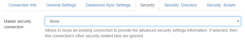

  1. Navigate to the Connections page. Click<your Web Services Conenctor>See the gear icon. >Edit.
  2. Click the Security tab.
  3. Master security connection: If you want to reuse the security information from another Connector, specify the security information of another connection so that you do not have to run a security sync operation for this connection.
Important!
If you create a Master security connection, skip the other security-related tabs on the Connections page.

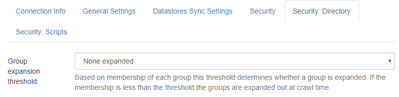

  1. Navigate to Connections. Click <your Web Services Connector>See the gear icon. > Edit.
  2. Click the Security: Directory tab.
  3. Group expansion threshold: By default, this setting is None expanded, which means at crawl time, you can see the list of users and groups that have access to an item, but you conserve system resources that would otherwise be used to expand a large groups of users.
    1. Alternatively, use the drop-down list box to choose a number.
    2. If that number of groups is reached or exceeded, the group is expanded and you can see which users are in which groups.
      Tip: Groups can contain both subgroups and users.

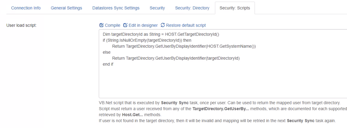

  • Navigate to Connections. Click <your Connector>See the gear icon. > Edit.
  • Click the Security: Scripts tab.
  • User load script: Use the provided script or write a VB.Net script that is executed by the Security Sync task, once per user security mapping. This script can also be used to modify the AD identifiers of users' security mappings.

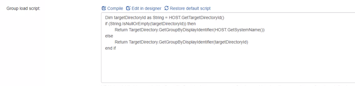

  • Group load script: Use the provided script or write a VB.Net script that is executed by the Security Sync task, once per group security mapping. This script can also be used to modify the AD identifiers of groups' security mappings.
  • Click the Compile button to validate your scripts.
Example: Set the ADID
See the following example of a user script that sets the ADID:
Copy
dim sysn as string = HOST.GetSystemName()
HOST.SetADID(HOST.GetDefaultDomain() & "\" & sysn.split(",")(1))
