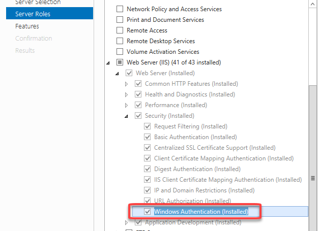

- Web Server IIS (graphic below)

The default installation of IIS 7 and later does not include the Windows authentication role service.
To use Windows authentication on IIS, you must do the following:
- Install the Windows Authentication role service (Web Server (IIS) > Security > Windows Authentication)
- Disable Anonymous authentication for your website or application
- Enable Windows Authentication for the site or application
