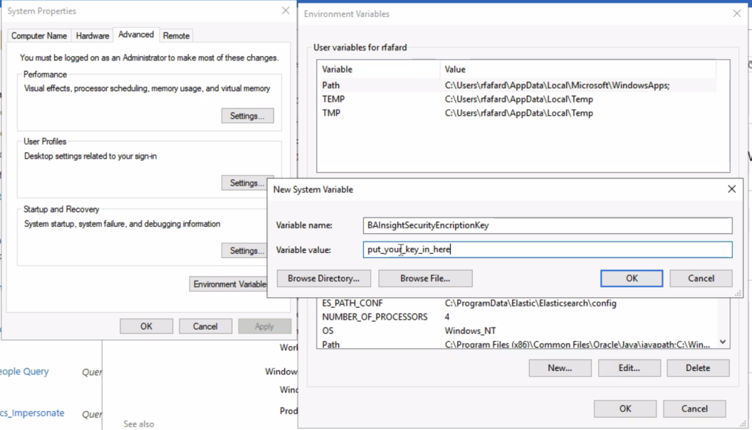

Environment Variables
If you are upgrading to Connectivity Hub v2.2, or if you modify the encryption keys below, on the machine running Connectivity Hub, you must set your environment variables, as described below:
Password encryption requires the following environment variables to be set:
- BAInsightSecurityEncriptionKey
- The value of this environment variable is used as key encryption algorithm.
- Example: RgUkXp2s5v8y/B?E(H+KbPeShVmYq3t6
- BAInsightSecuritySaltKey
- The value of this environment variable is used as a salt key for the encryption algorithm.
- Note that BAInsightSecuritySaltKey value must be at least 8 characters.
- Example: TjWnZr4u7x!A%D*G-KaPdRgUkXp2s5v8

- Create the two BA Security environment variables, listed above.

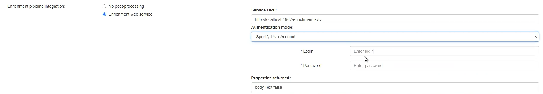

- If you use Content Enrichment and specify a user account for authentication:
- Navigate to the Enrichment Pipeline integration
- Enter your user account Login and Password
- Click Save
