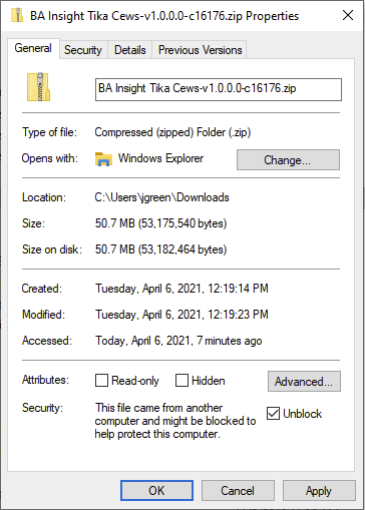

- Unblock the downloaded .zip file.

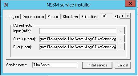

- On I/O tab redirect both
stdoutandstderrto the path C:\Program Files\Apache Tika Server\Logs\TikaServer.log.

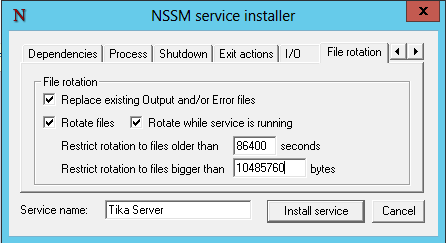

- On the File Rotation tab, configure a time or size based log file rotation:
- java.exe in the Path text field:

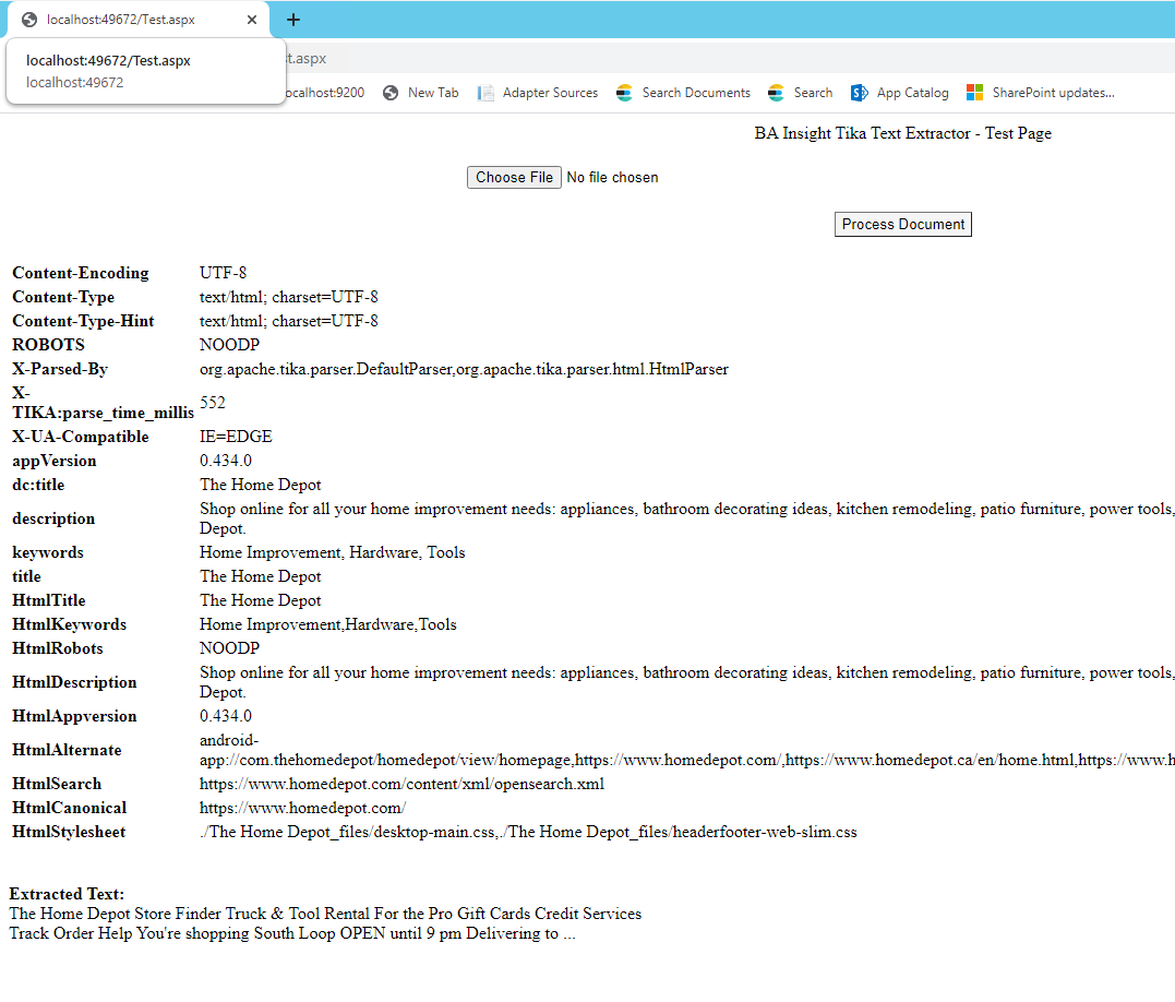

- To test the service, navigate to the service URL: http://localhost:7890/Test.aspx.
- Click browse, and select a text file (.txt).
- Click the Process Document button to see the extracted text metadata.
- The test page can be used to determine available metadata for processing.
- Metadata and/or body text can be consumed by Connectivity Hub.
Test Page Providing Available HTML Metadata
