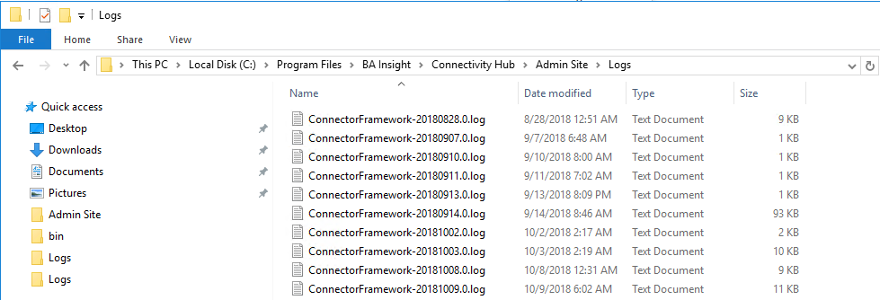

To see or edit the Logging.config for the admin site, navigate to the Connectivity_Hub_root -> Admin Site - >Logging.config
To see the log entries, navigate to the folder where ConnectivityHub is installed > Admin Site > Logs
In general, you should view the log files located here to discover why:
- You cannot save a specific content or connection
- You cannot an exception when performing an UI operation, like opening a target, dataset etc
- You cannot connect to cache/configuration database
- Content test bench shows an exception/error/warning

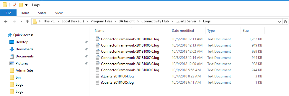

- To see or edit the
Logging.configfor scheduler service, navigate to the folder where ConnectivityHub is installed > Quartz Server >Logging.config. - To see the log entries, navigate to the folder where ConnectivityHub is installed > Quartz Server > Logs.

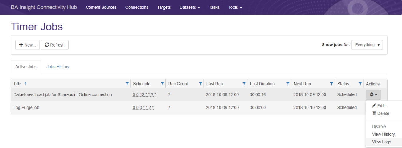

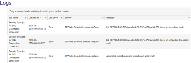

- Depending on the logging level selected while starting or scheduling a job, all or a part of the log entries can be seen from Admin Site > Tools > Logs
- The information logged by each task in particular can also be seen from Tasks > Actions > View Logs
- You should check the Timer Job Logs for:
- Unexpected behavior when you run the target sync.
- Items missing from incremental crawl.
- Unexpected behavior when you run Security Sync or any other connection task.
