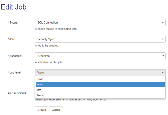

For example, you must specify the type of logging.
In order of verbosity:
- ERROR
- WARN
- INFO
- TRACE: The most detailed log report. Select only if necessary.

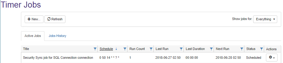

Specify the Logging Level for a Job
- From the Connections page, select <your connection> > Tasks >
> Tasks.
See the "Time Jobs" pop-up.
- Log level: Use the drop-down to select.
- Active Jobs: See the jobs.

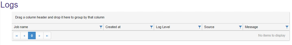

- For a given job, click
> View Logs: for more information.
