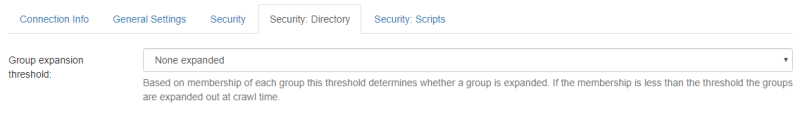

Configuring Active Directory Mapping for Your Connector
How to Configure the Active Directory
Navigate to Connections and click <name of your Connector> >
> Edit > Security Directory:to see the Security Directory page. Click to see the Security Scripts page.
- Group expansion threshold:
- Determines the maximum number of users that must be present to form an expanded group.
- For example, if you specify
10, group that have less than 10 users are marked as expanded. - All expanded
- Default
- All groups are expanded.
- Only users are specified in the document ACL.
- Save: Click to save your changes.

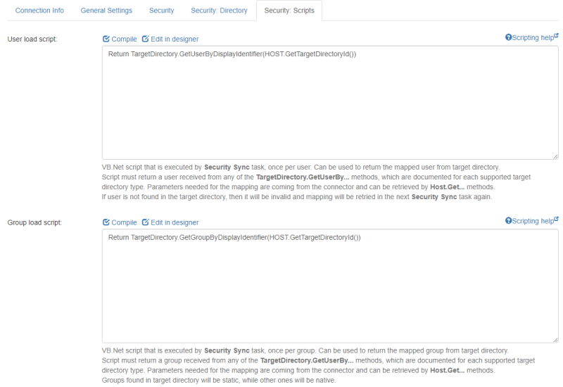

Security Scripts
- Navigate to the Connections page. Click <name of your Connector> >
> Edit > Security Scripts to see the Security Scripts page.
- For additional filtering, write VB.Net scripts to filter users and groups from the source system.
- Each script is called once for each user or group.
- The script cannot return a value.
- You cannot skip users or groups using VB scripting.
- For more information, go to Scripts.
Note: You cannot skip users or groups using VB scripting.

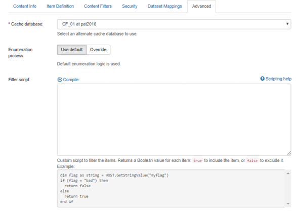

Filter Users and Groups
Select a content source and choose which items are excluded from the crawl when you choose to apply filtering using a VB.NET script.
- Navigate to the Content Sources page:
- Click <name of your Connector> >
> Edit. - On the page that appears, click the Advanced tab.
- Filter Script: Enter your filter script using the example in the UI.
- Compile: Click to compile and verify your script.
Note:
Make sure that this script returns a Boolean value.
In this case:
True = add this user or group
False = exclude this user or group

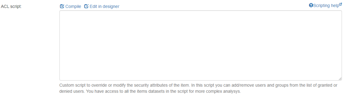

Access Control
Access control lets you access, or restrict access to, more groups and users.
- Navigate to Content Sources.
> Edit. On the Edit WebService/Dataset/... page that appears, click Advanced. - Scroll down to access the ACL Script field.
- Click Compile at the top of the field to compile and verify your script
