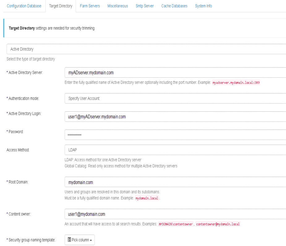

Example: Azure AD Domain Service in ConnectivityHub
Shown in the example below is an instance of a ConnectivityHub with the Target directory configured to use an Azure AD Domain Service.
