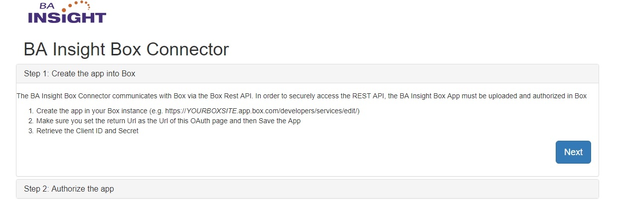

  1. Log on to the server where the connector is installed using Windows Remote Desktop.
  2. Open a browser window.
  3. Go to: http://locahost:<port number>/OAuth.aspx where <port number> is the port number chosen in during the installation process.
The page appears as shown below:

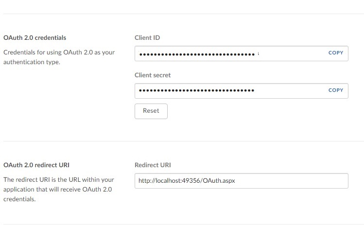

Gather Connection Details (Edit the Box.com Application)
  1. In the edit application page, scroll down to the "OAuth2 Parameters" section.
  2. Set the Redirect URI to the Authorization page as mentioned in the Authorization Page section of this documentation. e.g. http://localhost:<port number>/OAuth.aspx
  3. in the Application scopes section, select the following checkboxes:
    1. Read all files and folders stored in Box
    2. Write all files and folders stored in Box (Note: this scope is required to download files. The Box connector will NOT make any changes in Box)
    3. Manage Users
    4. Manage Groups
      and
    5. Manage enterprise properties.
  4. Copy the Client_id and Client_secret values into a text document, using a program like Windows Notepad - these values are needed in later steps.
  5. Press the Save Changes button

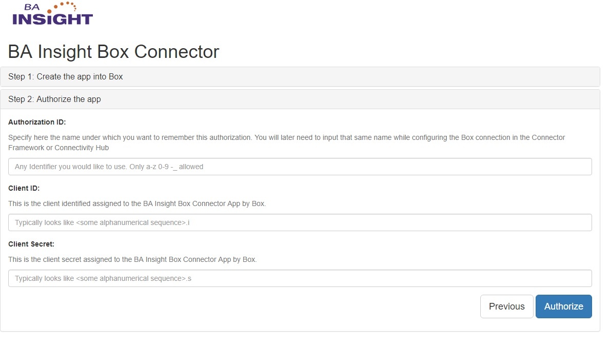

  1. Once you have saved the Box application, return to the Authentication page and click the Next button.
  2. A section, as shown below, appears:
  3. Insert an Authorization ID which is a name given to the current authorization process.
    Note: Remember this name or save it in a text file because it is required when creating a Box Connection.
  4. Insert the Client ID and Client Secret values that you saved from the Box Application in the previous steps.
  5. Click Authorize.

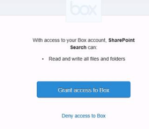

  6. The browser redirects you to a new page where you can grant your newly created app access to Box, as shown in the graphic below:
  7. Click the Grant access to Box button.
  8. Enter the credentials of your Box account that was used to create the Box application.

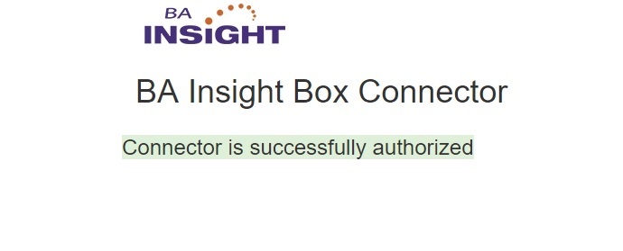

  9. Once the permissions have been successfully granted, the following page appears:
  10. You can now close the page.
