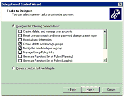

Delegate Rights to the AD "OU" Group
Using the Delegation of Control Wizard in Active Directory to establish the following settings.
