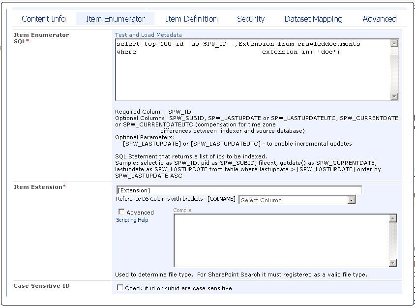

  1. In The Framework Admin Console select the Content tab.
  2. On the Content Management Page select the Content Source.
  3. Click the Item Enumeration tab.
  4. Item Enumerator SQL:
    • To edit, click Override Template and enter a SQL statement that returns a list of items to be indexed.
    • If your data contains a last update date, the framework can leverage that date to do high speed incremental updates.
    • If not provided every crawl will fully refresh the index.
    • After entering your SQL click the Test and Load Metadata link above the entry box to validate your query and preload the "Select Column" quick-pick boxes.

        Sample:
           select id as SPW_ID, pid as SPW_SUBID, fileext, getdate() as SPW_CURRENTDATE, lastupdate as SPW_LASTUPDATE from table where lastupdate > @SPW_LASTUPDATE order by SPW_

  5. Item Extension:
    1. This is the associated extension of your item in the index and will determine the icon that is displayed in the search results.
    2. If the output extension is not in the list of the accepted File Types in the search admin, it will be skipped.
    3. It is also the default extension used for any unstructured files that don't explicitly have an extension, like blobs.
    4. For more information, seeStandard Format Field.
  6. Check Case Sensitive ID if either ID or SubID is case sensitive.
  7. Click Save.
