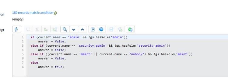

By default, the condition declares:
  • ADMIN role: Seen only by users who are members of the ADMIN role.
  • SECURITY_ADMIN role: Seen only by users who are members of the SECURITY_ADMIN role.
  • MAINT role and NOBODY role: Seen only by users who are members of the MAINT role.
  • All other roles are seen by users as they are configured in the rules.
The condition must be changed. To change it, use the following instructions:

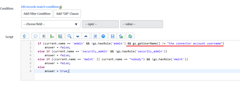

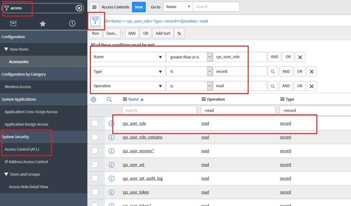

  1. Rule is defined by default in the tenancy – in the System Security > Access Control List page:
  2. Next, Elevate roles to SecurityAdmin privileges so that you can edit the record.
  3. Edit the script of the record and ensure the user name is same one the connector uses and is returned as "true".
  4. Alternatively:
    1. Remove the script all together
      or
    2. Add another line at the top of the script:
      if(gs.getUserID() == “The connector user sys_id”)
          answer = true
      else ….<the original snippet> ….
      More available functions here: https://www.servicenowguru.com/scripting/user-object-cheat-sheet/
