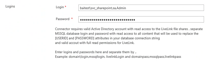

- Specify the additional settings in the Content Info page:
- Logins: Enter logins and passwords into this field.
- The Content Server Connector requires:
- Valid account with full READ permissions for LiveLink
- READ access to the Content Server (LiveLink) file shares
- Separate Oracle database login and password with READ access to all the content that will be used to replace the
[USERID]and[PASSWORD]attributes in your database connection string - Valid Active Directory account with:
- Separate the logins and passwords using a comma (,).
- Login:
domain\login,mssqllogin,livelinkLogin - Password:
domainpass,mssqlpass,livelinkpass
