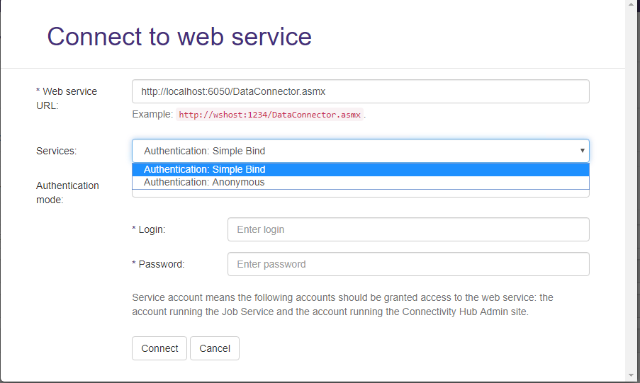

  1. Connect to web service and choose one of the two services depending on your directory authentication settings:
    • Services
      • Authentication: Simple Bind - The default LDAP authentication mechanism (using the LDAP BIND operation).
      • Authentication: Anonymous - Use to access the LDAP server without specifying a username or password.
  2. Click Connect.
