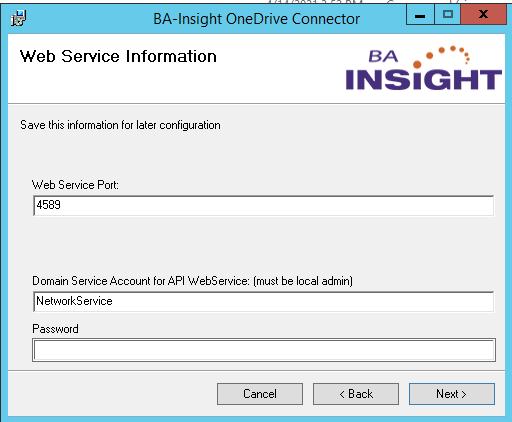

  3. ClickNextto proceed, until you reach the "Web Service Information" screen, shown below.
  4. DO NOTuse the provided, default Domain Service Account "NetworkService."
    1. Enter a valid local user account with admin rights on the local machine in the formatdomain\username
    2. Enter the accountPassword.
  5. ClickNext.

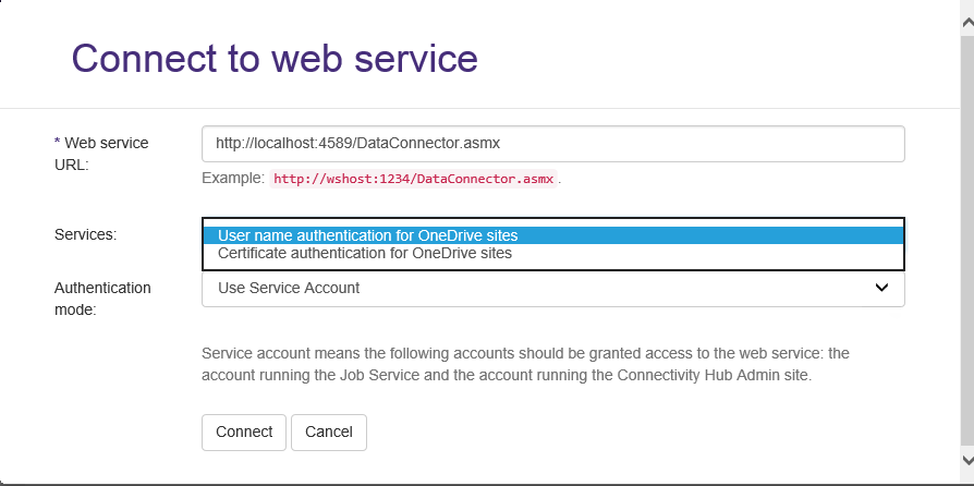

Set the Connection
  1. After setting your generic information, click theConnect or Refresh Web Servicelink.
  2. Select the appropriate authentication mechanism:
  3. The page refreshes and displays additional settings.

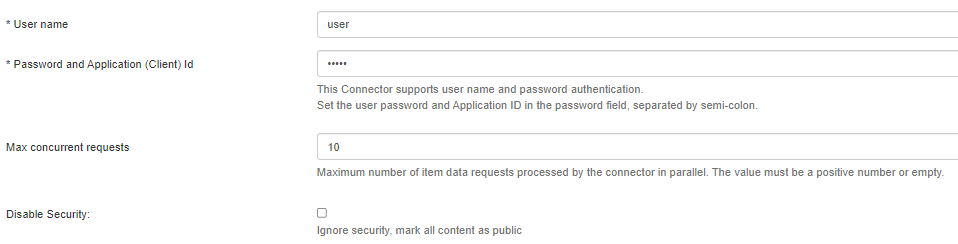

    Username Authentication Settings
  4. In theUser name field, enter the user with the appropriate permissions for crawling the configured site collection
    1. If AUTOFETCH is used (i.e. no mailbox filters are used or if a filter containing the wild mark (*) symbol is used): Tenant admin permissions are required
    2. If AUTOFETCH is not used (i.e. mailbox filters are added for each individual site collection): Edit permissions are required for each site collection
  5. In thePasswordfield, enter the user password first and the Application ID, separated by the semi-colon ";" sign.

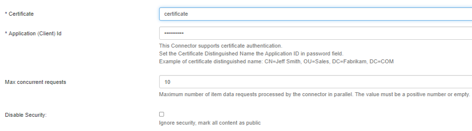

    Certificate Authentication settings
  6. In theCertificatefield, enter yourCertificatecommon name.
    If you copy your certificate details, as shown in the Certificate console graphic below, your syntax will contain unnecessary spaces.
    You must ensure you enter your certificate information in syntax without spaces or your certificate will not work.
    CORRECT SYNTAXexample: "CN=Jeff Smith"
    INCORRECT SYNTAXexample: "CN = Jeff Smith"
  7. In thePasswordfield, enter the Application ID. This is a GUID such as "c87a7836-a1da-455c-9171-836bf793c195".

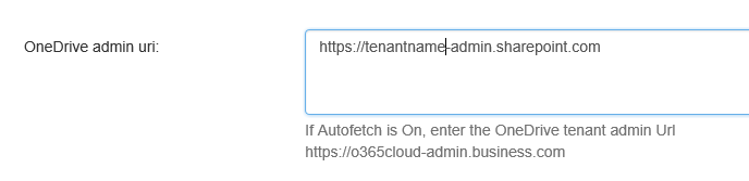

  2. OneDrive admin uri. Refer to the graphic below for sample values.
    1. Enter the following value in the following order, as shown in the graphic below, one per line:
      1. Admin URL

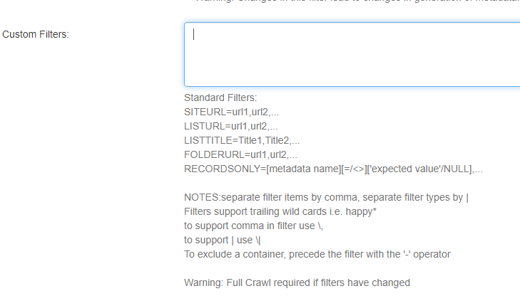

For a given content source, you can apply additional filters to decide which list or item to crawl.
Use the following syntax for the filters:
  • LISTURL =url1,url2,...
  • LISTTITLE=Title1,Title2,...
  • FOLDERURL=url1,url2,...
  • SITEURL=url1,url2,…
  • RECORDSONLY=[metadata name][=/<>]['expected value'/NULL]
  1. Separate filter items using a comma (,) and separate filters with a character pipe (|) character.
  2. Filters support trailing wildcards.
  3. To use a literal comma (,) or a pipe character (|), precede the character with a backslash (\,), or (\|), respectively.
  4. If any changes are made to this field, a full crawl is required to properly refresh the index.
  5. The records only option can be used to only return metadata for the items matching the condition specified.

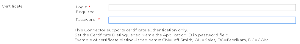

Update the OneDrive Connection with the Certificate and Azure App Information
  1. Open your Connector Framework.
  2. Click theConnectionslink from the top navigation.
  3. Select your SharePoint Online v2.0 connection from the drop-down menu.
  4. Navigate to the Certificate portion of the page.
  5. Enter the credentials (Login and Password) of your OneDrive connection:
  6. Login(required):Enter the Certificate Distinguished Name.
  7. Password(required): Enter the Azure Application ID.
    Note
    : You can find the Azure Application ID when you access your Azure App in the registered applications from the Azure Portal:
