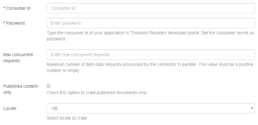

The Practical Law connection requires the following settings:

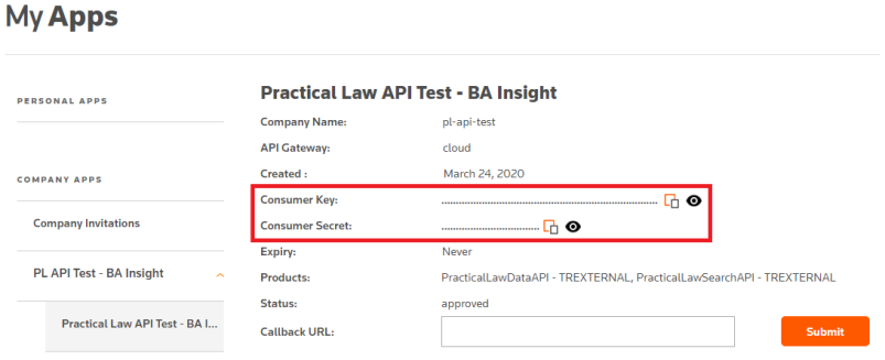

  • Consumer Id:
    • "Consumer Key" from the Thomson Reuters Developer Portal (requires login).
    • See the graphic below.
  • Password:
    • "Consumer Secret" from the Thomson Reuters Developer Portal (requires login).
  • Published content (optional):
    • Published content check box is an optional setting to limit crawled documents to published ones.
  • Locale (optional):
    • A connection can crawl documents from one locale only.
    • It must be selected from the provided list.

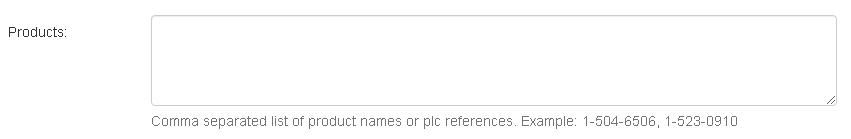

  1. Products: Specify a comma separate list of products to crawl in the form of product names or plc references
    Important!
    Enter only products that you have access to! Inaccessible documents are marked "failed" during crawls.
