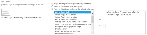

  4. Click  and select Site Settings> Look and Feel > Page layouts and site templates. Go to Page Layouts and add (Welcome Page) Compact Search Results to the list on the right. Scroll down the page and click OK.

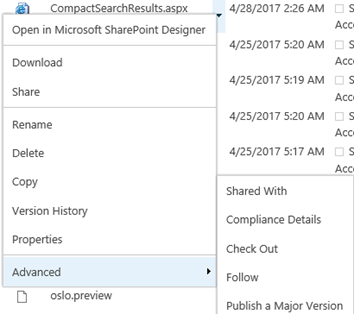

  9. Click and select Site contents > Master pages and page layouts. Find CompactSearchResults.aspx, click on the page and from the drop-down under Advanced, select Publish a major version.

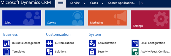

  1. Log into Microsoft Dynamics CRM using appropriate permissions.
  2. In the Main menu, go to Settings > Solutions.
  3. Import: Click Import and upload the BAI Dynamics Add-on ZIP file.
