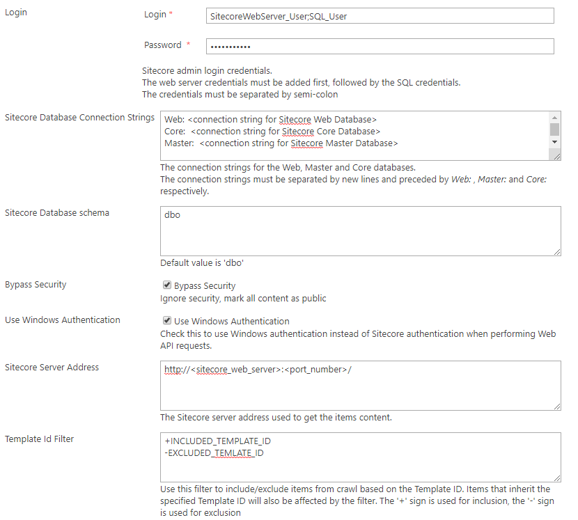

How to Configure Your Connection
  1. Login: Enter web server credentials and the SQL user.
    1. Both logins and passwords must be separated by a semi-colon.
    2. If Integrated Security or a SQL user is specified in the connection strings, (in step 2), then only the web server credentials can be added.
  2. Database Connection strings: Enter the three connection strings for each Sitecore database:
    • Web
    • Core
    • Master
  3. Enter the three connection strings on separate lines and preceded by their type. See the graphic below:
    Example:
    Copy
    Web: Server=sqlserver;Database=Sitecore_web;Integrated Security=True
    Core: Server= sqlserver;Database=Sitecore_core;Integrated Security=True
    Master: Server= sqlserver;Database=Sitecore_master;Integrated Security=True
  4. Sitecore Database schema:
    1. Enter the schema for the Sitecore databases.
    2. Default value: dbo.
  5. Bypass Security:
    1. Check if all content should be marked as public.
    2. The security is retrieved from the Sitecore Core database.
  6. Use Windows Authentication:
    1. Ensure the login represents a Windows user.
    2. By default this is set to "false" and the Login represents a Sitecore user.
  7. Sitecore server address:
    1. Enter the Sitecore server address.
    2. This will be used the make REST API requests to get the page content.
  8. Template ID Filter:
    1. Filter used to include or exclude items based on their template IDs or the template IDs that are found in the inheritance path.
    2. The template ID can be found on the Admin Console.
      1. Excluded template IDs are preceded by the minus ( - ) sign.
      2. Included template IDs are preceded by the plus ( + ) sign.
      3. If an included filter is added, only items that are using or inheriting the specified template ID are crawled.
      4. By default all items under ‘sitecore/content’ and ’sitecore/media library’ are crawled.

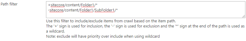

How to Configure Your Content Source
There is an optional content setting to filter items during crawl.
  • Specify a list of paths to be included or excluded during a crawl.
  • The paths must be separated by new lines.
  • Wildcards (*) and both inclusion and exclusion rules are supported by preceding the path with the +/- signs.
  • Exclusion rules have priority over inclusion when using wildcards.
In the example in the picture below, everything "under" Folder1 is crawled except SubFolder1.
