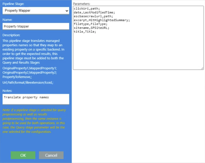

Example Pipeline Stage: Property Mapper
In the example below, the SmartHub Property Mapper pipeline stage maps two terms:
  • "title"
  • "file type"
This results in SmartHub users discovering consistent results when searching content across different content sources.

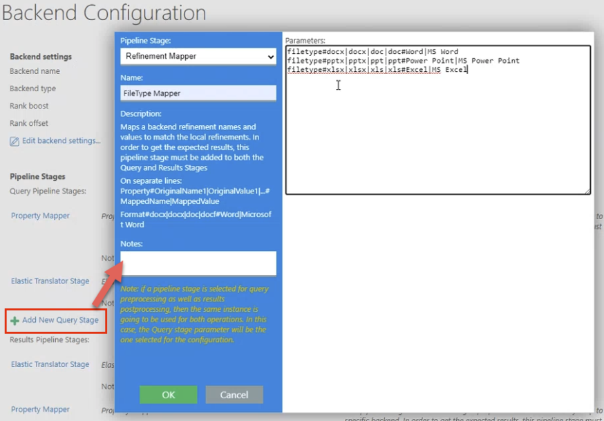

Backend-specific Pipeline Stage

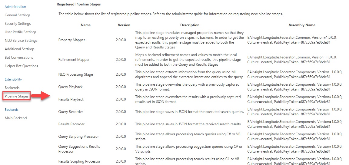

Registered Pipelines
You must use a Registered Pipeline stage.
  • Available (Registered) Pipeline stages are listed within your SmartHub administration site (http://<SmartHubURL>/_admin).
    See the graphic below.
    • Select Pipeline stages from the left-side navigation menu to see a list of registered pipeline stages.
  • To register a new Pipeline stage, click the link at the bottom of the page (not shown in the graphic below).

  • Property Mapper
    • Translates named property names to that these names map to an existing property on a specific backend.
    • In order to get results, this stage must be added to both the Query and Results stages.
  • Refinement Mapper
    • Maps backend refinement names and values to match the local refinements.
    • In order to get the expected results, this pipeline stage must be added to both the Query and Results stages.
