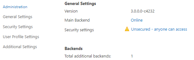

  4. General Settings:
    • SmartHub Version: 2.x. Set by default.
    • Main Backend: The main backend settings.
  5. Security Settings:
    • Authentication Mode: Specify the authentication type.
      Note: Every authentication mode comes with its own UI.
    • Admin Users: Specify users that are allowed to access the admin page.
    • Trusted App Redirect URLs: Specify the apps that are allowed to communicate with SmartHub.

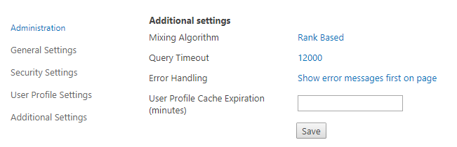

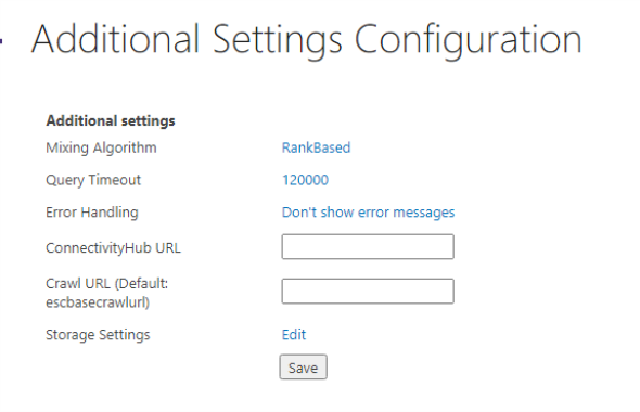

  7. Additional Settings:
Specify Results Ordering
Normalize Your Results
  • Normalize your results, or prioritize content sources, by specifying a mixing algorithm.
  • Mixing algorithm means the order in which the search results are displayed on the results page.
  • If you set the mixing algorithm to Rank based in the Administrator user interface, the SmartHub search results are shown in descending order.
  • While ranking scores apply only within the search engine, the mixing algorithm normalizes results across your search engines.
    • For example, a 1,000 point score from search engine A might not be equivalent to a 1,000 point score from search engine B.
    • The equivalent score on engine B might be 500, or 5,000.
    • The rank-based mixing algorithm ensures that when the results are merged, end users see their results sorted by decreasing relevancy (or your specified relevancy score).
  • An alternative to applying the mixing algorithm to search engines is to rank one content source over another.
    • For example, a regional farm using SmartHub might want to rank its local content over its corporate content.
    • Conversely, a global deployment might choose to rank headquarters content higher than its regional content.
  • To perform a ranking operation, modify the mixing algorithm values.
Specify the Mixing Algorithm
  1. Go to the SmartHub Additional Configuration page.
  2. Mixing Algorithm: Click and the SmartHub pop-up window appears.
    This window enables you to chose a mixing method:

Specify the Query Response Time
  2. Query Timeout: Click and the SmartHub pop-up window appears.
  3. Query timeout: The query, or backend, timeout represents the time span (in milliseconds) that is allocated to each backend for query response.
If a backend is not capable of returning results in the specified time span, an error is displayed on the search result page:
See the warning.

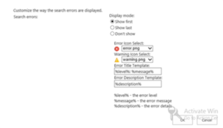

Customize Your Search Error Display
  2. Error Handling: Click and the SmartHub pop-up window appears.
    See the Search errors section of the UI.
  3. Display mode:
    • Show first: Search errors appear at the top of the search results. Enabled by default.
    • Show last: Search errors appear at the bottom of the search results.
    • Don't show: Search errors are not displayed.
  4. Error icon: Select the .png icon that appears for errors.
    After you make a selection, the related Error Icon or Warning Icon changes.
  5. Warning icon: Select the .png icon that appears for warnings.
  6. Error Title Template: Choose one/both:
    • error level: %level%
    • error message: %message%
  7. Error Description Template: %description%: the error details
  8. OK: Click OK.
