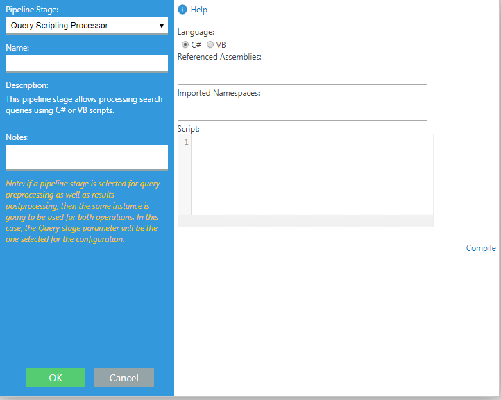

  1. Go to the <name of your backend> → Pipeline Stages
  2. Click "Add New Query" or "Add New Results Stage"
  3. The pipeline page appears. The "Query Scripting Processor" stage is shown below.
    The page layout changes depending on the Pipeline Stage selected from the drop-down menu.
  4. Enter the following values for each field:
      1. Pipeline Stage:
        1. Click the down arrow and select your stage from menu that appears.

        10. Query Scripting Processor
          1. Processes search queries and translates managed property names so that these names map to an existing property on a specific backend.
          2. Use this stage to process the received search query requests by providing complete scripting access to the SearchQuery object.

    1. Compile script:
      1. Use this option within the large text area, or as a link on the SmartHub Search Service page.
    2. Referenced assemblies
      1. Optional.
      2. Specify which assemblies the script needs in order to run.
      3. The format is one line per assembly and you must specify the assembly using the Fully Qualified Assembly format.

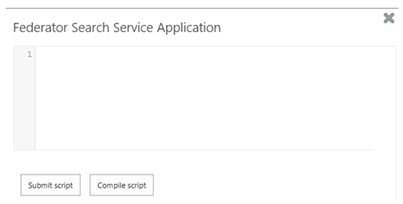

      6. Script
        1. Double-click to access the large text area:
          See the Search Service Application window.
  5. If your script throws an error see the red explanatory text below the Script box.
  6. Submit script:
    1. Click the Submit script button after you finalize your script.
