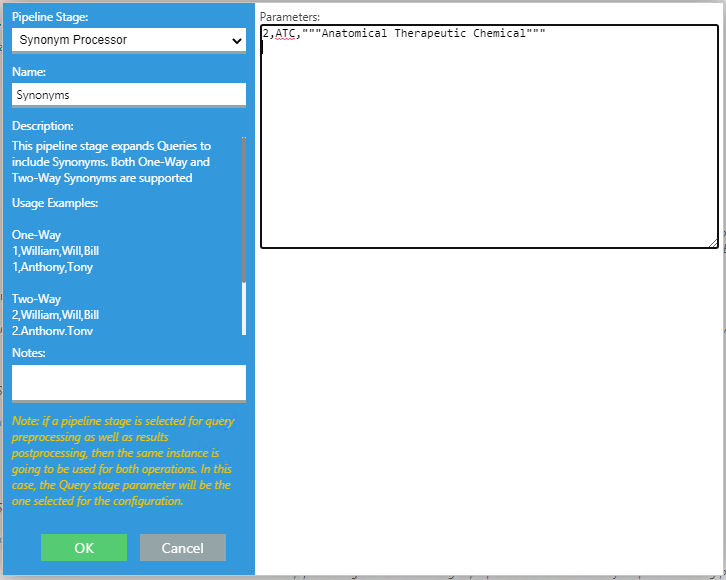

Multiple Word Synonyms
The Synonym Processor is capable of using multiple word synonyms.
  • Multiple word synonyms are treated as exact search terms.
  • Example:
    •   2,ATC,"""Anatomical Therapeutic Chemical"""
    •   2,ATC,Anatomical Therapeutic Chemical
Both formats will be treated within the processor as "Anatomical Therapeutic Chemical"
  • To query as multiple Synonyms use the format:
    •   2,ATC,Anatomical,Therapeutic,Chemical

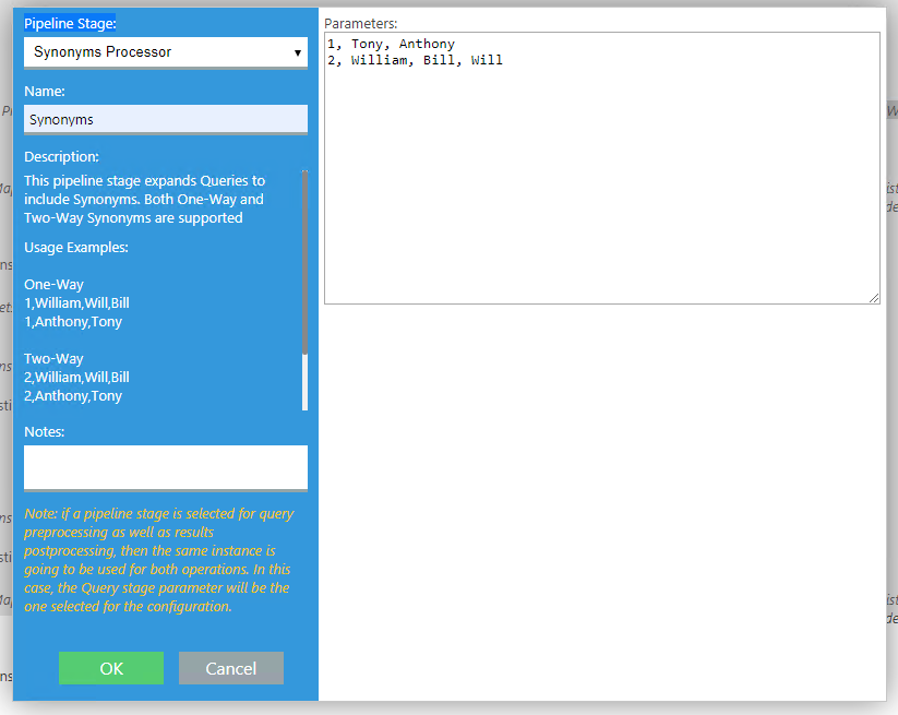

How to Add the Synonym Processor Stage and Configure It
  1. To add the Synonym Processor stage, navigate to the SmartHub Administration settings page.
    • For example, http://<SmartHubURL>/_admin.
  2. Select the Main Backend.
  3. Select Add New Query Stage.
  4. Select Synonyms Processor from the drop-down list.
  5. Enter your parameters in the Parameters field.
  6. Click OK.
