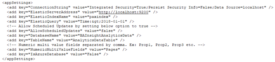

  2. Open the configuration (config) file and complete the following keys:
    1. ConnectionString
      1. Your SQL Server connection string.
      2. Default Value: Integrated Security=True;Persist Security Info=False;Data Source=localhost
    2. ElasticServerAddress
      1. Path to your elastic index
      2. Default Value: http://localhost:9200
    3. ElasticIndexName
      1. Name of the index that is wanted to be exported
      2. Default Value: paxindex
    4. ElasticQuery
      1. Write any valid elastic query(if left empty, it's going to run a wild card search, by default it is going to return all entries starting with 2018)
      2. Default Value: Time:>2018-01-01
    5. AllowScheduledUpdates
      1. Value must be set to either "true" or "false"
      2. Default Value: false
    6. DatabaseName
      1. The name you want for database/ The name of database created in Azure Sql Server
      2. Default Value: BAInsightAnalyticsData
    7. TableName
      1. The name you want for data table
      2. Default Value: AnalyticsDataTable
    8. NumericMultiValueFields
      1. Enter any numeric fields that support multi value
      2. Default Value: Pages
    9. IsAzureDatabase
      2. Default value: false
      3. In case that Analytics data are exported to an Azure Database, this option must be configured on "true".
      4. Note: The Azure Database (DatabaseName) must be created manually.
  3. Run AnalyticsExporter.exe.
  4. Wait for the tool to finish exporting. Export complete.

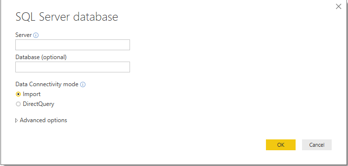

  1. Click the Get Data link and select SQL Server (if you have used AnalyticsExporter or any other tool to export data to a SQL database).
  2. Server: Enter your database server: localhost (for example).
  3. Database (optional): Enter the database name BAInsightAnalyticsData.
  4. Press OK.

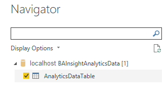

  5. Select AnalyticsDataTable.
  6. ClickLoad.

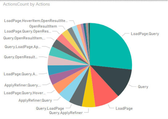

  7. Now you can select your fields and any type of visualization you would like.
    An example of a Pie chart for the different types of Actions based on BA Insight's analytics index is shown here:

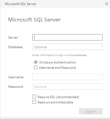

Use Analytics Data in Tableau
  1. Import your Data Source into Tableau.
    Note: If you are using SQL Server, a prompt appears for database name, user, password etc..
    1. Server: Enter your database server.
    2. Database: Enter BAInsightAnalyticsData.
    3. Select authentication type and enter log-in credentials, if necessary.
    4. Click Sign In.

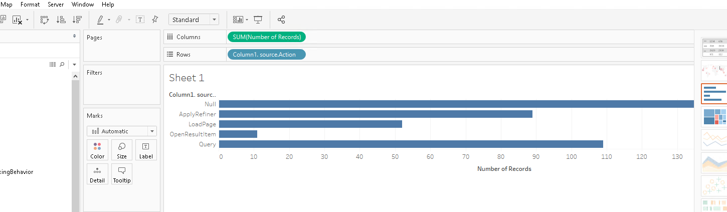

  2. Here you can create a type of visualization to best use your analytics data.
    Here we have created horizontal bars for the type of actions found in our report, based on the number of records.
