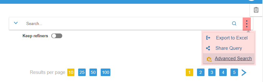

How to Access Advanced Search
  1. To get to Advanced Search click displayed on the right side of the search box, then click on "Advanced Search" link.

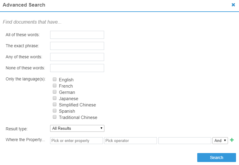

  2. This opens the Advanced Search modal window as shown below.
  3. Type search terms into the search boxes, and use the options shown to further refine your search.

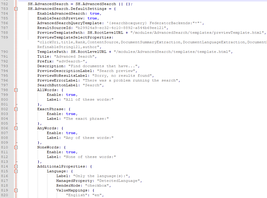

  • To configure the Advanced Search feature, copy some or all of the Advanced Search module configuration settings into your page’s custom settings file and modify them as you see fit.
  • Advanced search settings from the file DefaultModuleSettings.js are shown in the screenshot below.
  • The settings for the Advanced Search module can be found in the the section SH.AdvancedSearch.DefaultSettings (around line 783) in the file DefaultModuleSettings.js, located in the directory <SmartHub_root>\modules\SmartHubResourceLoader\DefaultModuleSettings.js
  • Section SH.AdvancedSearch.DefaultSettings (around line 783) in the file DefaultModuleSettings.js is shown below.
  • Modify the settings as described below.
DefaultModuleSettings.js: Advanced Search setings
Do NOT modify the DefaultModuleSettings.js configuration file as it is overwritten at upgrade time.
All the changes to the settings should be done using the page's custom settings file.
To see an example of a custom settings file see the provided custom settings for the custom Index.html page: <SmartHub-root>\CustomerCustomization\settings\IndexCopyCustomSettings.js

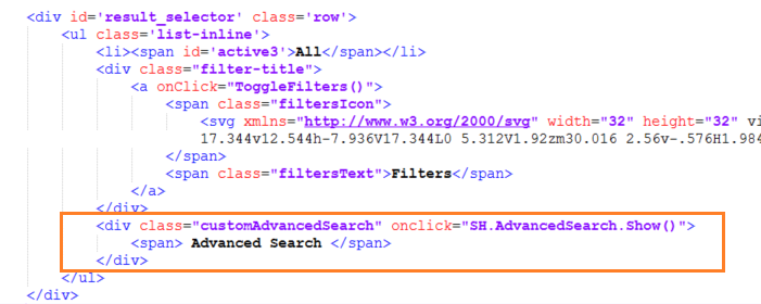

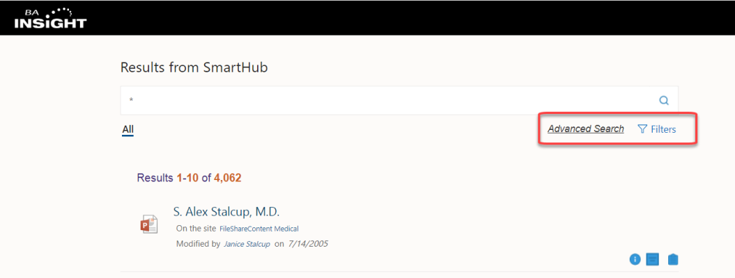

Adding Advanced Search to a New Custom Page
In order to add the Advanced Search button on a custom page follow these steps:
  1.  Edit your HTML page by adding the following code block:
    <div class="customAdvancedSearch" onclick="SH.AdvancedSearch.Show()">
    <span> Advanced Search </span></div>
  2. Style your button using the customAdvancedSearch class.
Example
For example, by default, the SharepointModern theme doesn't contain the Advanced Search button.
  1. To add it, edit the Results.html page.
  2. Add the code in step 1, above.
