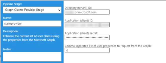

User claims in Smart Hub
  • SmartHub extracts only the On-Premise ID and UPN for the current user
  • The user property id is not be present by default. To retrieve it use the Graph Claims Provider Stage, shown below.
    • Graph Claims Provider Stage
      • Use to extract any user property from graph, such as id

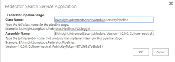

  7. In the Federator Search Service Application screen, add the following values:
    • Class Name: BAInsight.AdvancedSecurityModule.SecurityPipeline
    • Assembly Name: BAInsight.AdvancedSecurityModule, Version=1.0.0.0, Culture=neutral, PublicKeyToken=8b346c7a0df406fd
  8. Click OK.

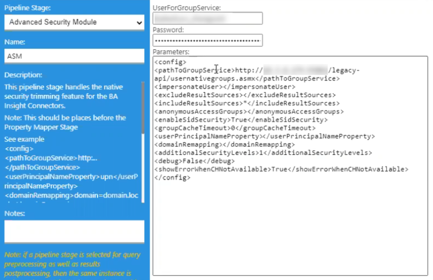

  3. Click Add New Query Stage.
  4. Pipeline Stage: Use the down arrow to select Longitude Security Trimmer.
  5. Name: Complete a name for your stage.
  6. Parameters: Copy and paste the following code, replacing the sample values with the appropriate values.
    Copy
    <config>
        <pathToGroupService>http:...</pathToGroupService>
        <domainRemapping>domain=domain.local</domainRemapping>
        <userPrincipalNameProperty></userPrincipalNameProperty>
        <groupCacheTimeout>5</groupCacheTimeout>
        <additionalSecurityLevels>0</additionalSecurityLevels>
        <enableSidSecurity>false</enableSidSecurity>
        <includeResultSources>*</includeResultSources>
        <excludeResultSources></excludeResultSources>
        <impersonateUser>domain\uA=domain\uB</impersonateUser>
        <debug>false</debug>
        <userForGroupService>user</userForGroupService>
        <passForGroupService>password</passForGroupService>
    </config>
