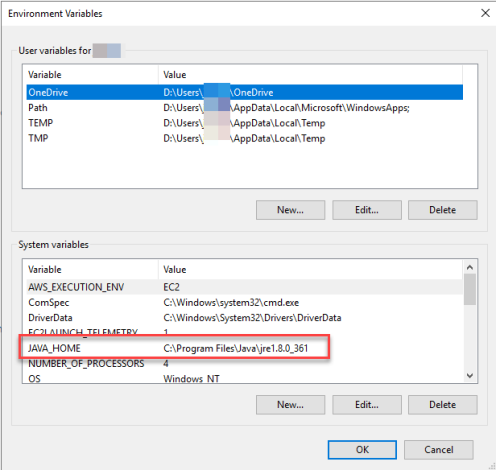

- Add a new system variable:
JAVA_HOME. - Specify the path to the Java install directory (root of
/lib /bin):

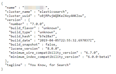

Verify the Elastic node status by going to http://localhost:9200.
Note: You must have an instance of Elasticsearch up and running.
Make sure that JSON is loaded. For example, see the following capture:

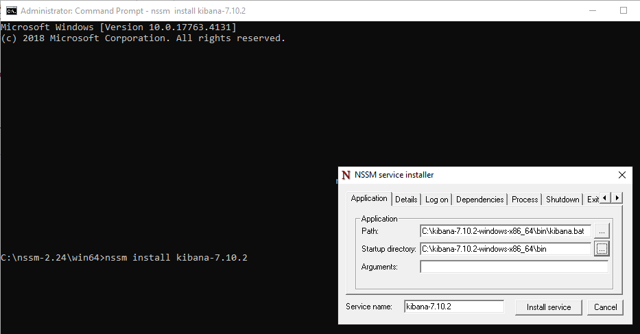

Use the command prompt with administrator permissions to navigate to the folder which contains nssm.exe:
cd path_to_nssm/nssm-2.24/win64
or -
cd path_to_nssm/nssm-2.24/win32
Run the command (version 7.0 used, for example purposes):

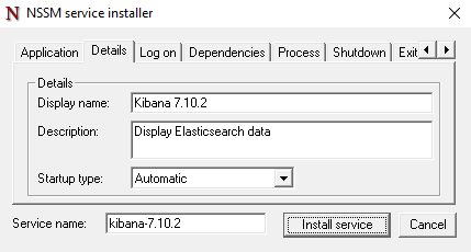

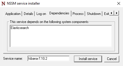

nssm install kibana-7.0.0In the "NSSM service installer" window:
Application tab: Set kibana.bat as Application Path (screenshot shown for example purposes only)
- Details tab: Enter display name, description, startup type
- Dependencies tab: Enter Elasticsearch service name
- Click the "Install Service" button.

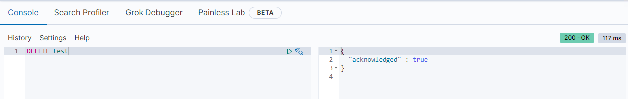

Go to Kibana address → Dev Tools.
Write in console "
DELETE test" to delete index.
