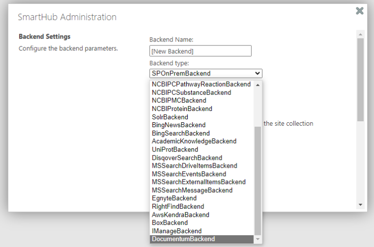

  1. Start by opening your SmartHub Administration site:https://<SmartHubSite>:<port>/_admin.
  2. Add a new backend.
  3. The Backend Settings page appears.
    Select DocumentumBackendfrom the "Backend type" drop-down menu:
