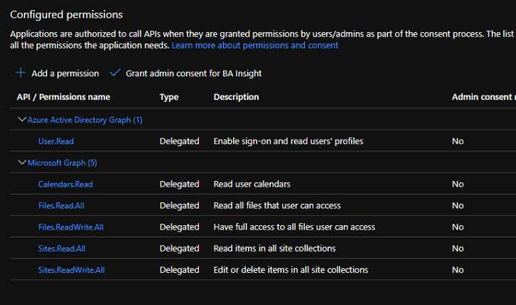

  3. Select API Permissions to open the settings menu panel.
  4. Click Add a Permission.
  5. SelectAPIs my organization usesand add the following permissions (as you type the name, it appears):
    1. Azure Active Directory Graph
      • User.Read
    2. Microsoft Graph
      • Calendars.Read.All
      • Files.Read.All
      • Files.ReadWrite.All
      • Sites.Read.All
      • Sites.ReadWrite.All
