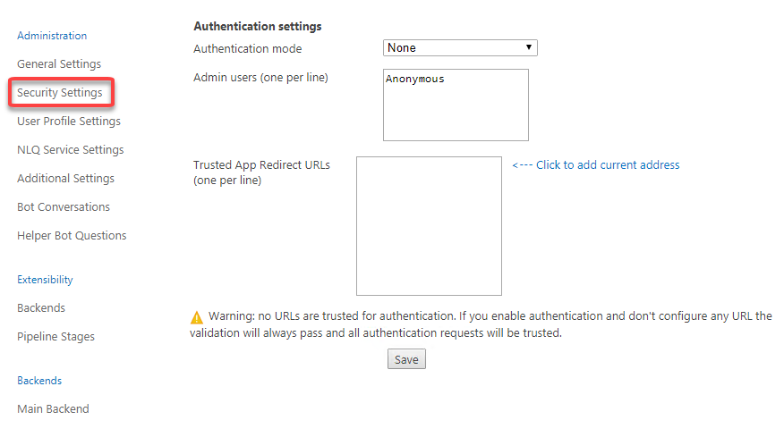

There are 5 different types of authentication you can select in SmartHub, including None (No Authentication).
Note: No Authentication is not recommended for security reasons.
Select one of five available authentication types:

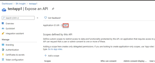

  4. Create the App ID URI.
    1. Click Expose an API section on the left side navigation menu.
      1. To manually set your App ID URI, click Set at the top of the page.
      2. To set your App ID URI automatically, continue to add a scope, below.

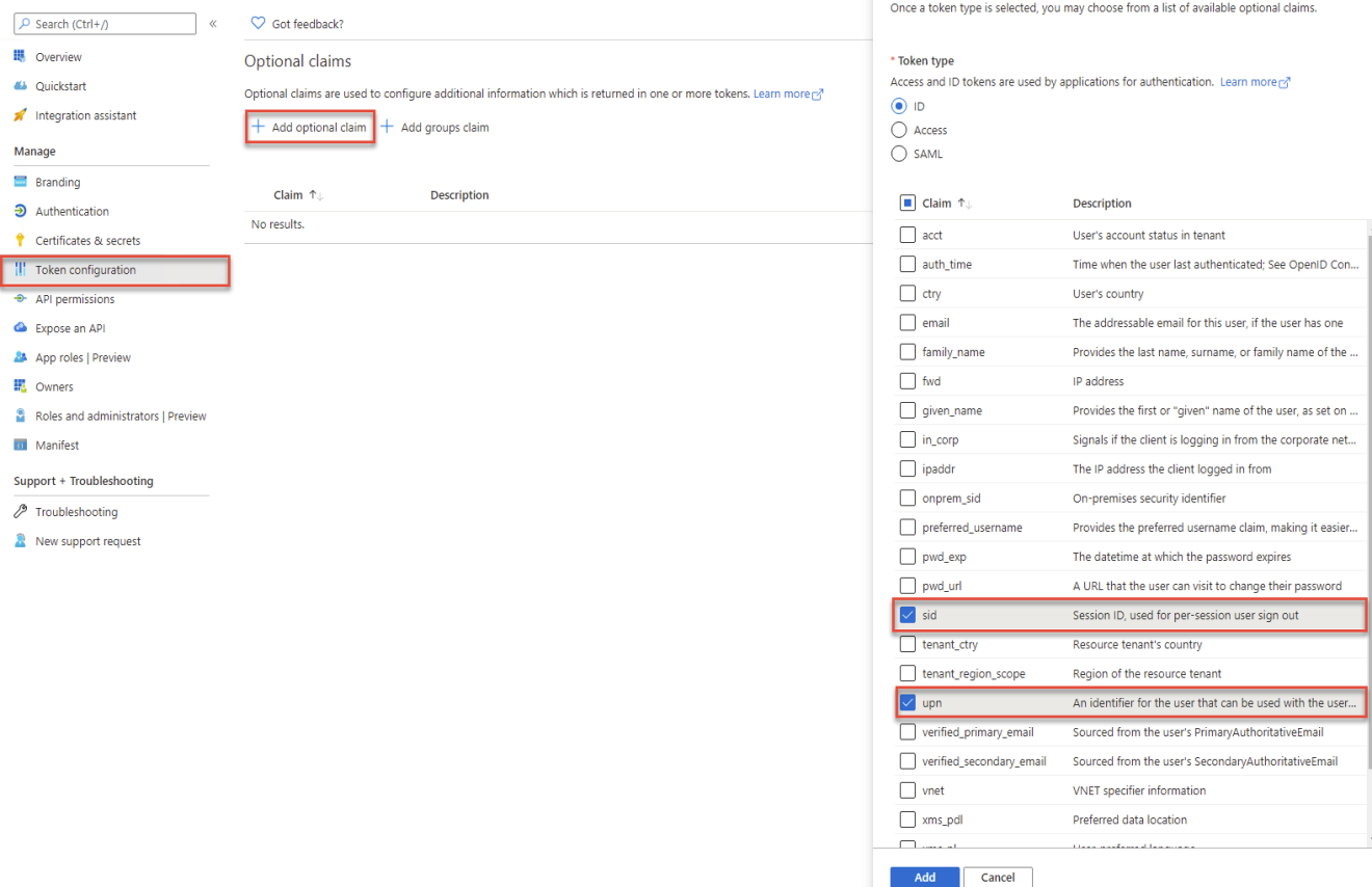

Token Configuration
  1. Select Token configuration from the left-side navigation.
  2. Click Add optional claim.
  3. Select ID as *Token type.
  4. Select upn and sid under Claim.
  5. Click Add.

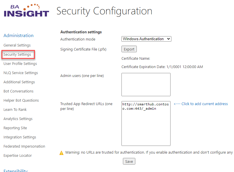

  2. Select Security Settings.
  3. Authentication mode: Select Azure Active Directory.

    5. Admins users (one per line): The local administrator account(s) email address (username@domain.com). Enter one user account email address per line.
    6. Trusted App Redirect URLs: List of application URLs that use SmartHub to validate the user's credentials.

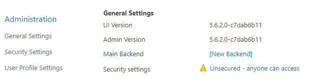

  4. Click Save to return to General Settings to see the "Security settings: Secured" message.

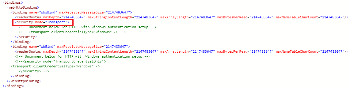

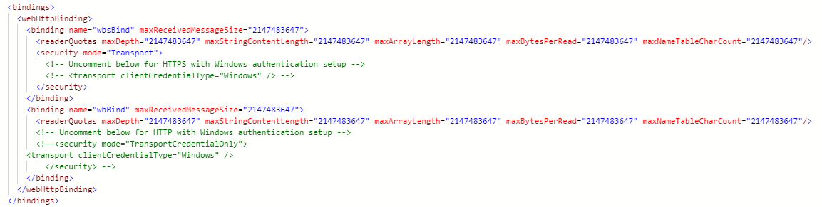

  5. Check the binding settings in the file web.config located at the SmartHub root level.
    1. Ensure the line <security mode="Transport"> is uncommented, as shown below.

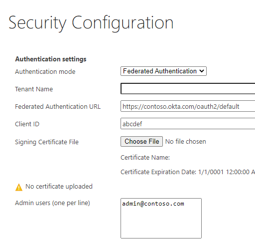

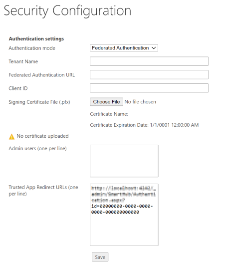

Use the following information to configure Federated-type user authentication in SmartHub.
About Federated Authentication
SmartHub supports Federated-type authentication, which is any authentication service that is OAuth 2.0 compliant.

Your Authentication Service must be configured using OAuth 2.0 with JWT tokens.
  • The JWT token generated by your authentication service needs to contain both the SID and UPN of the user.
  • Decode JWT tokens at https://jwt.io/.
SAML authentication is not supported.

  2. Security Settings: Click "Security Settings" and the Authentication settings page appears.
  3. Authentication mode: Select Federated Authentication from the drop-down menu.
  4. Tenant Name (optional). Enter the name of the tenant for your Federated Authentication service.
  5. Federated Authentication URL (required): Specify your Federated Authentication service URL.
  6. Client ID (required): Specify your app ID.
  7. Trusted App Registrations: If you need to use another app between SmartHub and the App used for Authentication, you must add a Trusted App Registration.
    Using this option you can send us a token generated by your app, and we will do the exchange between your app and app used for authentication in SmartHub.
    1. Navigate to Azure APP → API Permissions → Add a permission → My APIs → Select your app used for Authentication in SmartHub → Choose Scope used in SmartHub for Authentication
    2. Client ID: The "Application ID" as shown in the Azure Portal App Registration page for your application
    3. Client Secret: The Client Secret generated for your app
  8. Signing Certificate File (.pfx):
    1. Click "Browse..." to upload a valid certificate (.cer ), without the private key.
      1. The certificate (.cer) must be exported from your authentication provider.
      2. The certificate is used to validate the tokens that your authentication provider generates.
        Note: Make sure your certificate has not expired.
        For more information about certificates, see: What Are Certificates?
  9. Admin Users: Enter the list of users who will enjoy administrative rights to your SmartHub site.
    1. User credentials must be entered in the format Domain\username or Username@domain.
    2. 'Anonymous' may be entered, but it is not recommended for security reasons.
    3. Groups are not supported.
  10. Make sure your Federated Service includes the UPN property in its claims for the user.
  11. Click Save and return to General Settings to see the "Secured" message:
Example Identity Provider: Okta
The following example describes how to configure Okta as your identity provider.
Note: You must have access to your Okta application settings on the Okta website.
Tenant Name is not required.
  • Authentication mode:
    • Select Federated Authentication
  • Federated Authentication URL
    • URL of your Okta Authorization Server: the server configured with the UPN claim in the ID token for the open ID (or All) scope
    • For example: https://<tenant>.okta.com/oauth2/default
    • See the example screenshot below
  • Client ID
    • The active application Client ID. Taken from the Applications page of the Okta web site. See below.
  • Signing Certificate File
  • Global Admins (one per line)
    • List of users to enjoy administrative rights to your SmartHub site. See Step 8, above.
  • Trusted App Redirect URLs
    • Click the link to the right of the field to add the current address.
  • Click Save when complete.
Use the following instructions to authenticate your SmartHub users using Microsoft Windows authentication.
Windows Authentication requires HTTPS and a URL with a fully qualified DNS name.
Set Your Authentication Mode in SmartHub
  1. Navigate to the SmartHub Administration page by going to the _ADMIN folder and navigating to the SmartHub admin User interface (UI).
    Alternatively, enter the following URL into your browser:
    http(s)://[web-app-url]/_admin
  2. Click Security Settings.
  3. The Authentication settings page appears.
  4. Authentication mode
    1. Select Windows Authentication
  5. Provide Certificate Details:
    A certificate is required to keep the user credentials encrypted and secure.
    If a certificate is not found in the security configuration file, a new certificate will be automatically generated when clicking "Save". The newly generated certificate will be available for 100 years.
    1. Signing Certificate File (required):  The Name and Expiration date of the generated certificate (if these 2 fields are blank it means no certificate exists yet)
    2. Export: Export the generated certificate as a .cer file
      Make sure that your certificate has not expired.
      For more information about certificates, go to: What Are Certificates?
  6. Admin Users: Enter the list of users who will enjoy administrative rights to your SmartHub site.
  7. Trusted App Redirect: Click the "<—Click to add current address" link on the page to enter your SmartHub site URL if it isn't currently there.
    1. Enter your SmartHub address. Include port number. The default HTTPS port is 443.
    2. This URL must be HTTPS and include a fully qualified DNS name. See the screenshot above in step 4.
    3. You can also enter the address (URL) of your SmartHub Analytics site.
  8. Click Save to return to General Settings to see the "Secured" message.

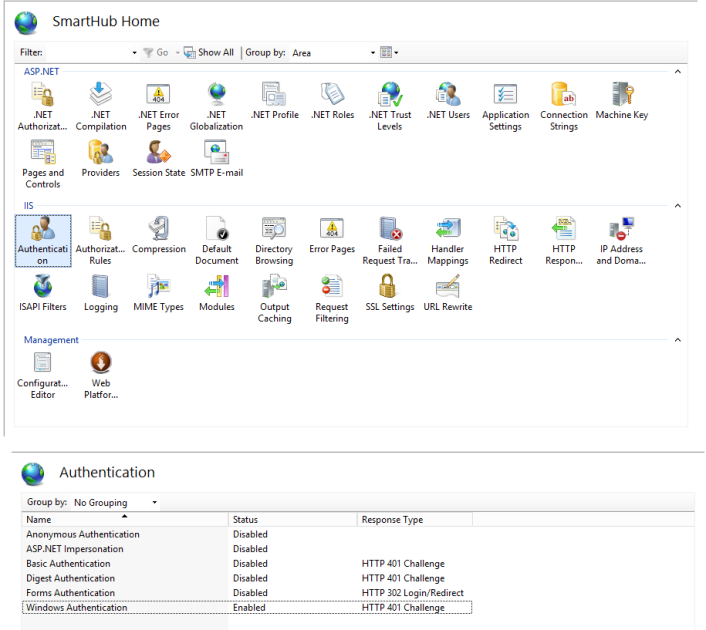

  1. Edit your SmartHub site in IIS Manager.
  2. Select IIS>Authentication.
  3. The Authentication window appears:
  4. Anonymous Authentication: MUST be set to Disabled.
  5. Windows Authentication: MUST be set to Enabled.
    1. Everyone that is configured in IIS under “Authorization rules” has access.
    2. Authorization rules are located next to "Authentication" from the IIS SmartHub site screen.

  7. Edit the web.config file in your installation directory
    1. Use a text editor to edit the web.config file that is located in the root folder of your SmartHub site.
    2. Uncomment BOTH wbBind and wbsBind <security> nodes as instructed in the file.

Use the following instructions to disable authentication to your SmartHub site by using the authentication mode "None."
  • If you set your SmartHub Authentication mode to "None", everyone has access to the SmartHub site.
  • BA Insight does not recommend this setting for security reasons.
  1. Admin users (one per line): Enter the list of users who will enjoy administrative rights to your SmartHub site.
    1. 'Anonymous' may be entered, but it is not recommended for security reasons.
    2. Groups are not supported.
    3. Typically, Admin users are set as the local farm account, SharePoint service account, or both.
    4. User credentials must be entered in the format Domain\username or Username@domain.
      For example:
      1. Domain50\User12
      2. UserSmith@contoso.com
  2. Trusted App Redirect URLs (one per line)
    1. Click the "<—Click to add current address" link on the page to enter your SmartHub site URL if it isn't currently there.
      1. You also enter the address (URL) of your SmartHub Analytics site.
  3. Click Save to return to the General Settings menu to see the "Secured" message.
