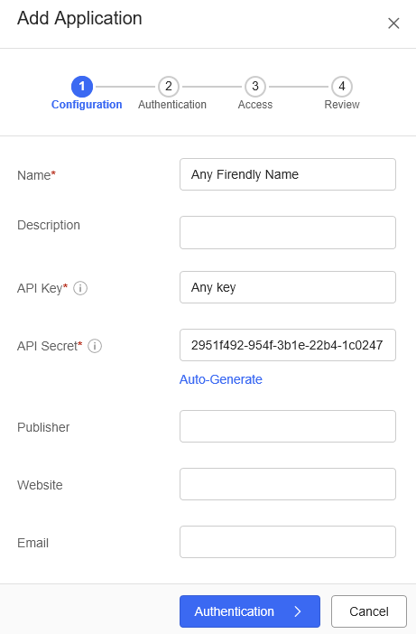

  6. Set the App:
    1. Name
    2. API key
    3. Generate an API Secret using the Auto-Generate link.
  7. Record the API key and secret: both are needed later.

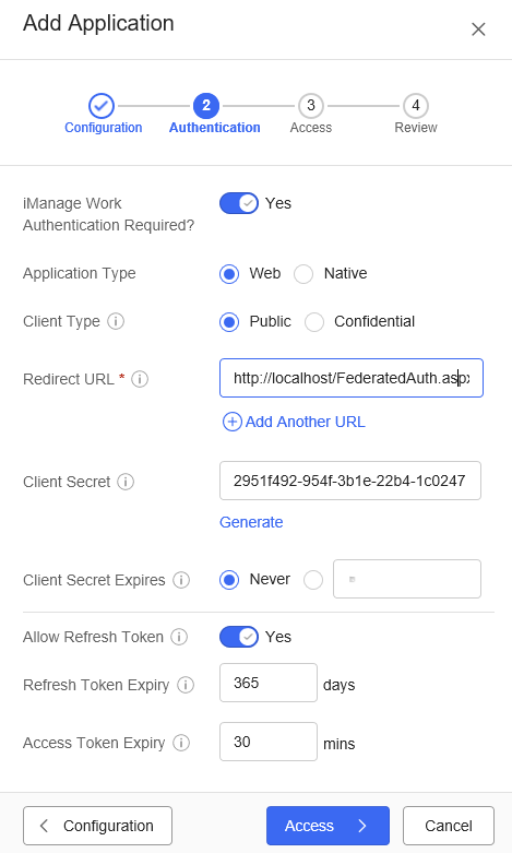

  8. Finally, press the blue 'Authentication' button.
  9. Set all the settings according to the screenshot below except for the following two:
    1. Redirect URL
      1. This must point to the file FederatedAuth.aspx in your SmartHub deployment.
      2. If SmartHub can be reached on the default port (80), then the URL in the screenshot can be used.
    2. Client Secret:
      1. This is automatically set to the value generated on the previous screen.
      2. Leave it unchanged.

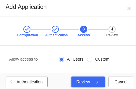

  10. Finally, press the blue 'Access' button.
  11. Select the 'All Users' options and press the 'Review' button.
  12. Press the 'Finish' button.

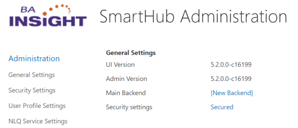

  1. Navigate to the SmartHub Administration page at http(s)://[web-app-url]/_admin .
    1. For example: http://smarthub.azurewebsites.net/_admin
  2. Go to the General Settings page.
  3. Add New Backend: Click the "Add New Backend" link to add your new iManage backend.
