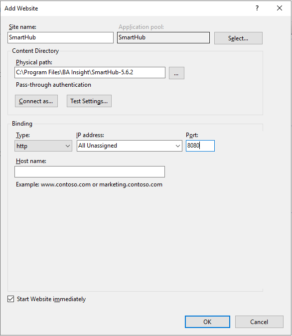

  1. Open IIS manager.
  2. Expand <Sites>.
    1. Right-click <Sites> and select Add Website from the pop-up window that appears.
  3. Site name:
    1. Enter your site name.
    2. For example, enter SmartHub.
  4. Application pool: Select an Application pool account that has FULL permissions to your SmartHub installation directory and the files within it.
    1. The default AppPool account DOES NOT have the necessary permissions.
    2. See the topic "How to Change Your Application Pool Identity Account" below.
  5. Physical path: Enter the path to the unzipped SmartHub package as shown in the graphic above.

  1. The Site Creation Wizard in IIS allows only a single binding when first creating a site (either HTTP or HTTPS).
  2. After you create your SmartHub site, create a second, additional binding to the same site (either HTTP or HTTPS).
  3. Port:
    1. Enter a port that is not used by another site from IIS.
      1. HTTP: Port 80 or 8080 is commonly used
      2. HTTPS: Port 443 is commonly used
  4. Host name
    1. Optional
    2. Enter a host name to restrict access to the host name (address your users enter into a web browser).
    3. The host name can be a DNS address, local machine name, localhost, and so on.
  5. Click Save.

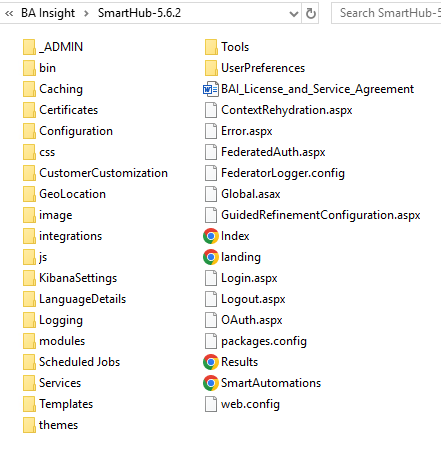

  6. If you select Content View from the bottom of your SmartHub Content site, your folder structure should resemble the structure shown below:
    1. Note: The "Configuration" folder does not appear until you have set your Authentication mode under the "Security Settings" category in the SmartHub Administration site.
IMPORTANT! To access the site, users must have READ access to the folder.
