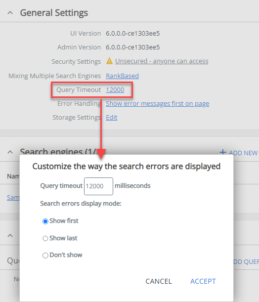

Specify the Query Response Time
  1. Go to the SmartHub ADMINISTRATION page.
  2. Query Timeout: Click the Query Timeout link. The SmartHub pop-up window appears.
  3. Query timeout: The query, or backend, timeout represents the time span (in milliseconds) that is allocated to each backend for query response.
If a backend is not capable of returning results in the specified time span, an error is displayed on the search result page:
See the warning.

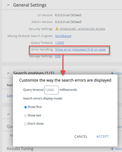

Customize Your Search Error Display
  2. Error Handling: Click and the SmartHub pop-up window appears.
  3. Display mode:
    • Show first: Search errors appear at the top of the search results. Enabled by default.
    • Show last: Search errors appear at the bottom of the search results.
    • Don't show: Search errors are not displayed.
  4. Click ACCEPT
