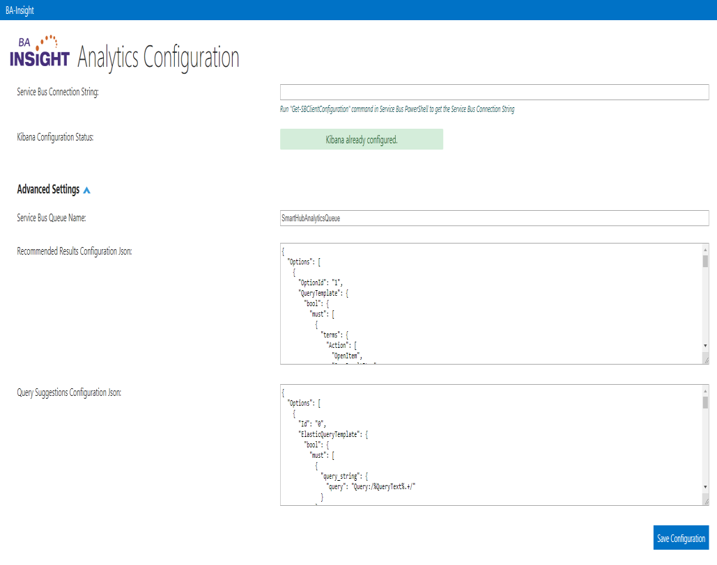

  1. Go to Analytics Configuration page.
  2. Add a new recommended result, using the format from the below example, in the Recommended Results Configuration Json setting.
    For example, if you use ID 100:
    Analytics config file:Recommended Results block
    "OptionId": "100",
    "QueryTemplate": {
        <your custom query to Elastic goes here, it can use lastDays and any other custom parameter as needed> },
    "QueryTransformation": "(%ORIGINALQUERY%) AND (%RECOMMENDEDITEMS%)"}
