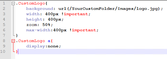

  1. Create your new CSS file. For example, New>text file, and name it.
  2. Place the CSS file into your custom folder in the SmartHub installation root directory.

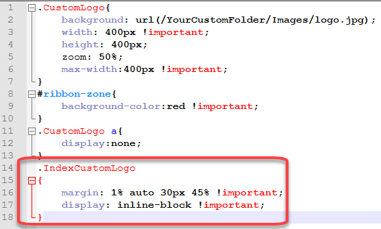

  3. Open the CSS file and set the properties of your logo, including its location.
    1. In the example below, the logo being used is named logo.jpg and it is stored in the folder /YourCustomFolder/Images/logo.jpg.
    2. NOTE! The first line in the CSS example file below is our class in .ClassName format: ".CustomLogo{".
      This class must match the class declared in your custom Results HTML file (or standard Results file, if not using a custom file).
      See the section "Modify (Custom) Results HTML File" below.
    3. Lines 8-10, in the example below hide the current, default logo image. These lines are not necessary for you to include unless you want to hide, instead of delete the current logo image.
  4. Save and close the file.

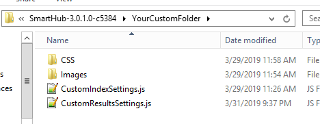

  2. Copy the file CustomSettingsTemplate.js.
  3. Paste the file into your custom folder (see the graphic below).
  4. Rename the file as you desire. In this example the file is named "CustomResultsSettings.js."

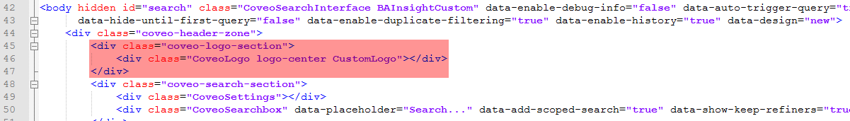

  1. Open your custom Results HTML file (such as CustomResults.html), or else "Results.html" if you chose not to make a custom Results HTML file.
  2. Navigate to the logo section - roughly line 46 (see the graphic below).
  3. Add "CustomLogo" to the existing code there:
    <div class="CoveoLogo logo-center CustomLogo"></div>

Create (or Modify) Your CSS File
  1. Open the CSS file from within your custom folder in the SmartHub installation root directory.
  2. Add the properties of your Index custom logo at the bottom of the CSS file.
    1. In the example below:
      1. The logo being used is named logo.jpg and it is stored in the folder /YourCustomFolder/Images/logo.jpg.
      2. On line 14, the Index custom logo is declared. Below line 14 the Index custom logo attributes are declared.
      3. Lines 8-10 in the example below hide the current, default logo image. These lines are not necessary for you to include unless you want to hide instead of delete, the current logo image.

  1. Navigate to the directory "C:\<SmartHubInstallationFolder>\modules\SmartHubResourceLoader".
  3. Paste the file into your custom folder (see the graphic below). Rename the file as you desire. In this example the file is named "CustomIndexSettings.js."

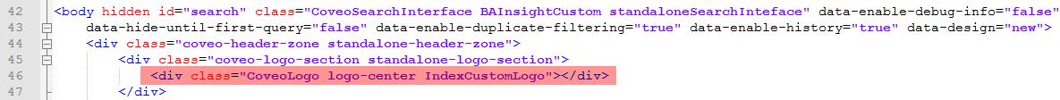

  1. Open your Index.html file from the root of your SmartHub installation directory.
  2. Navigate to the logo section of the file (roughly line 46) (see the graphic below).
  3. Add "IndexCustomLogo" to the existing code there:
    <div class="CoveoLogo logo-center IndexCustomLogo"></div>
