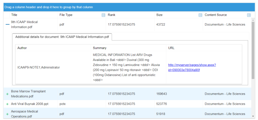

How to View Query Results in a Tabular View
The Tabular View component is used to display the SmartHub results as a tabular view.

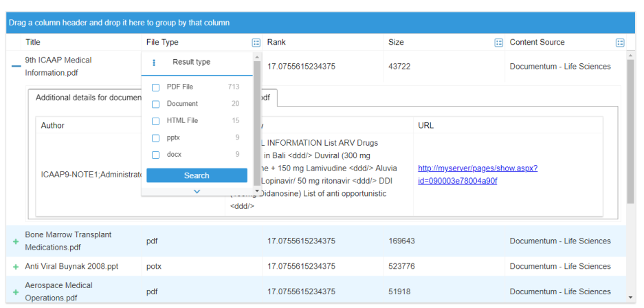

If a Tabular View column is set as filterable and the field used for that column is also a SmartHub facet, the facet is rendered as a Tabular View filter.
  • SmartHub and Tabular View do not support duplicate facets.
  • Additional templates like the detail templates do not support SmartHub facets.

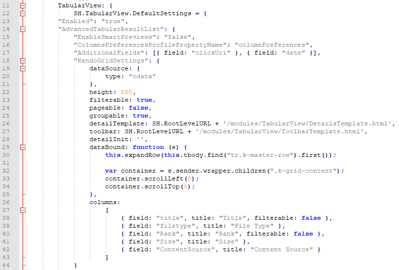

Tabular View Settings in a Custom File
In the example below, the Tabular View settings (from line 936) in the file DefaultModuleSettings.js have been inserted into a custom Results HTML page settings file (such as ResultsCustomSettings.js) at line 12 in the file.
  • The Results HTML page has a placeholder for Tabular View settings around line 11, depending on other custom modules being implemented.
  • Default: Tabular View is disabled.
  • The value "Enabled" on line 13 below, is set to "false"
  • In the example below the value "Enabled" on line 13, is set to "true"
Tabular View Settings Example

The AdditionalFields settings option can be used to request additional metadata that are not used in the columns section.
  • For example, the user can request metadata that can be used in a Detail Template.
  • The Tabular View settings are built on the KendoGrid settings.
  • The users can add their existing KendoGrid settings inside the KendoGridSettings field.
