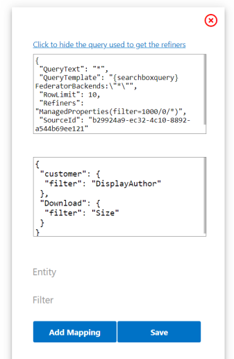

Entity-to-Filter Mappings
This section contains mappings between SmartHub filters/refiners and NLQ Service application entities.
  • An entity from the NLQ Service application must have a connection to a refiner from SmartHub.
The managed property used as a filter (refiner) must be searchable and queryable.
  • The "Click to show the query used to get the refiners" link opens a sub-section with the query run in the search center to get the managed properties.
    • The administrator can change it
  • The administrator must choose an "Entity" and a "Filter".
  • Click the "Add Mapping" button and after all changes are made, click "Save".

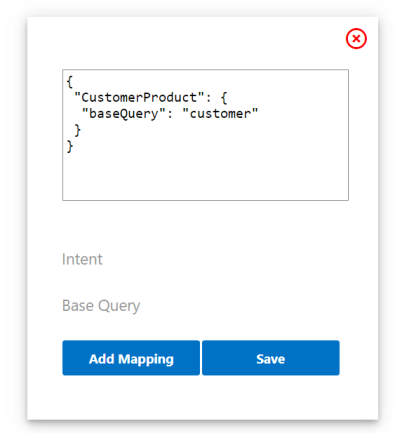

Intent-to-Base Query Mappings
This section contains the mappings between:
  • The intentsfrom NLQ service application,
    and
  • A query
Mappings Used in This Case
After the NLQ service detects:
  • The intent of the question
    and
  • The user follows the conversation steps,
then SmartHub returns the results:
  • Based on the user choices
    and
  • The query associated with the intent.
Example
Based on the code in the image below, the following query is run in the Search Center:
customer AND "DisplayAuthor":"Administrator".

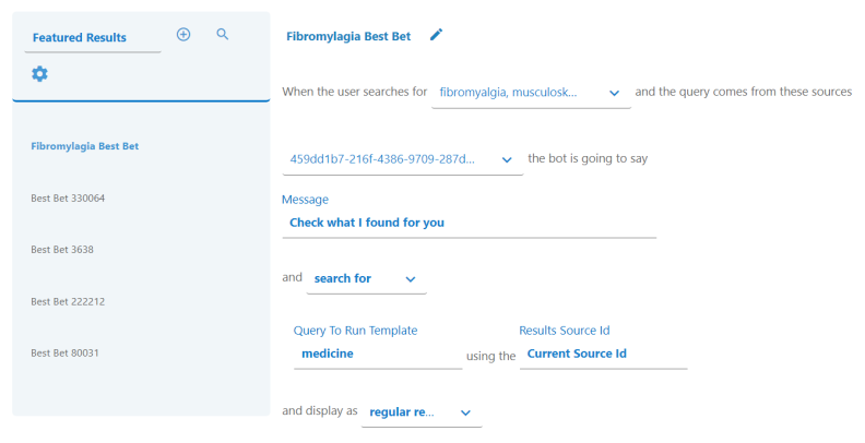

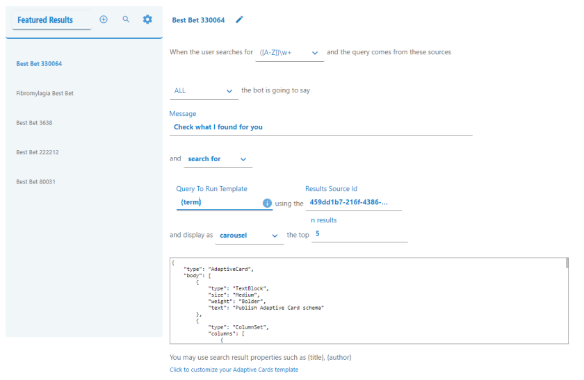

How to Configure "Featured Results"
Use the following instructions to configure a Featured Results.
  1. Click on "Conversation Topics" under "Bot Conversations" .
  2. Select "Featured Results".
  3. Click the "+" icon next to the "Featured Results" text at the top left of the screen.
  4. Choose a relevant name for the Featured Result
  5. Added query terms.
    There two types of query terms:
    1. Regular strings. For example: priority, case, version
    2. Regex stringsPattern for regex matching. For example: ([A-Z])\w+
  6. Added results source ids. This field will contain a list with results source ids of the user's query
    • "ALL" is the default value. It means that all results source ids will be considered as valid.
  7. Choose the response method:
    • "answer"  - "HTML response": What the bot tells the user before the results are listed.
    • "search for" - "Query To Run template":
      • Generates the query made to SmartHub if a match is found for this item (hover over the icon to see which fields can be used inside the template).
      • Choose a results source ID used to run the query and display results. The default value is "Current Source Id" which represents the result source id of the query made by user.
      • Choose the template from the last field:
        • Regular results
        • Cards
        • Carousel
      • For cards or carousel display mode choose.
        • n results - the top n results will be listed in SmartHub search page.
        • Adaptive Cards JSON - The JSON template used to render the bot results.

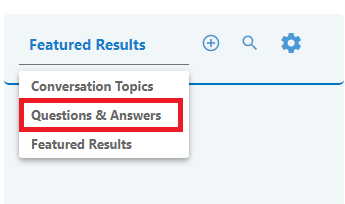

How to Configure "Questions & Answers"
Use the following instructions to configure a Question and Answer.
  2. Select "Questions & Answers".
  3. Click the "+" icon next to the "Questions & Answers" text at the top left of the screen.

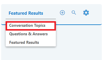

How to Configure "Conversation Topics"
Use the following instructions to configure a Conversation Topic.
  1. Click on "Conversation Topics" under "Bot Conversations".
  2. Click the "+" button.
  3. Choose a relevant name for the Conversation Topic.
  4. Choose the NLQ Service intents that match this Conversation Topic.
