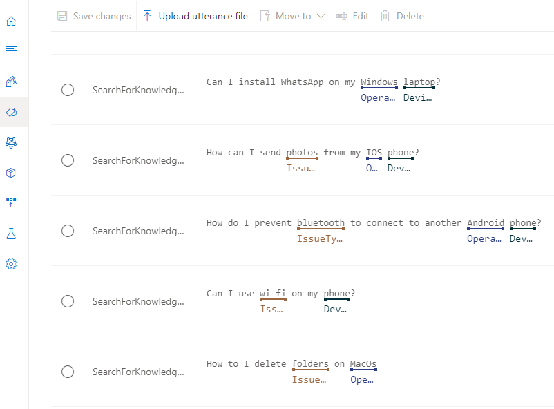

SearchForKnowledgeArticles Intent Example
In the example below, the intent "SearchForKnowledgeArticles" is shown.
Every line contains an utterance.
Entities in each utterance are highlighted in blue.
Note that entities such as IssueType, OperatingSystem, and Devices are a kind of keyword that can be recognized by your app.

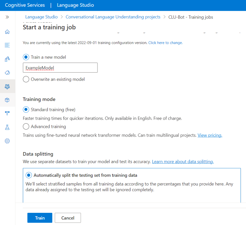

How to Train your CLU App
Select Training jobs from the left menu.
Select Start a training job
Enter a model name
Select Train

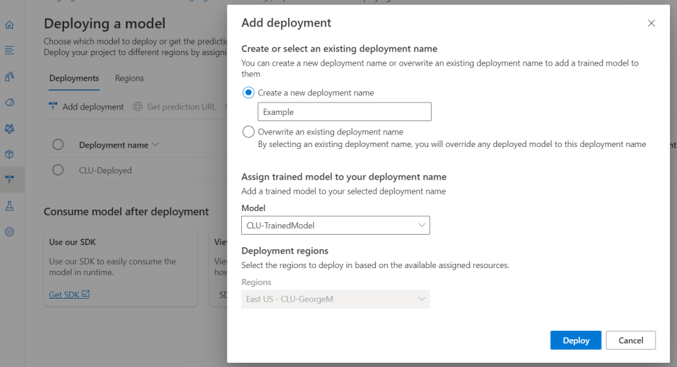

How to Deploy your CLU App
Select Deploying a model from the left menu.
Select Add deployment
Enter a deployment name
Select your trained model from above step
Select Deploy

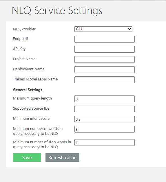

CLU Settings
The NLQ Service Configuration page can be found by accessing the NLQ Service Settings page from the Administration page:
Note: At least 1 one the 3 words must be a stop-word.
Minimum intent score
Minimum number of words in query necessary to be NLQ
Minimum number of stop words in query necessary to be NLQ
The administrator needs to complete the following fields from NLQ Service Configuration page:
Endpoint
The NLQ Service Endpoint.
API key
The purpose of the key is authoring
Project Name
CLU Project Name
Deployment Name
CLU Deployment Name
Trained Model Label Name
CLU Trained Model Label Name
Maximum query length
Maximum query size.
Supported Source IDs
Enter the result source IDs, comma separated, which invoke the call to the NLQ service.
Example: b29924a9-ec32-4c10-8892-a544b69ee121,b09a7990-05ea-4af9-81ef-edfab16c4e31
Indicates the minimum prediction accuracy for intent.
A prediction score is between 0 and 1.
Is an integer.
Is an integer.
A stop word is a commonly used word (such as “the”, “a”, “an”, “in”).
