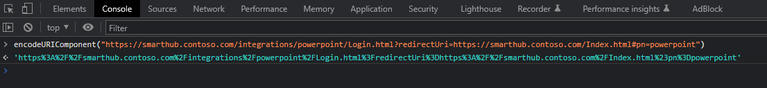

URLs can be encoded by opening a Browser Console (F12) and applying encodeURIComponent function to desired URL:

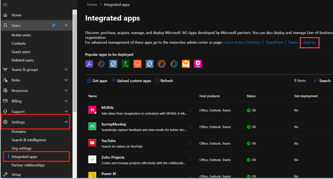

  1. Access the Services & add-ins page as an Administrator: https://admin.microsoft.com/AdminPortal/Home#/Settings/AddIns

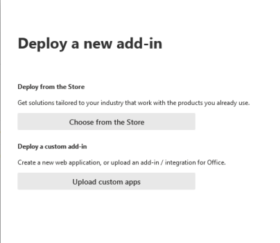

  4. Click Upload custom apps.

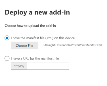

  5. Select "I have the manifest file (.xml) on this device."
    1. Click Choose File and browse to the .manifest file delivered with the SmartHub package.

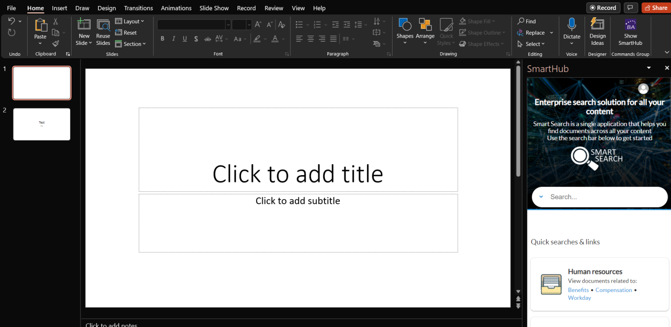

  1. Users can enable Hub in their PowerPoint instance by going to Insert → Get Add-ins → Admin-managed and add "SmartHub ".
  2. The SmartHub button can be found in PowerPoint → Home → Show SmartHub

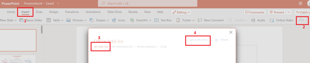

  1. Go to PowerPoint 365 (it works only for PowerPoint browser version).
  2. Open a presentation.
  3. From Menu -> Select Insert -> 3 dots from right side -> Add-In -> My ADD-ins -> Upload My Add-in.
  4. After these steps, you should be able to access the SmartHub from your presentation.
