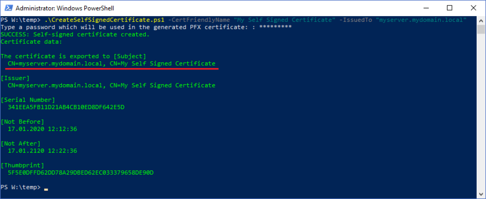

  7. Sample script output is displayed in the screenshot below.
    1. Copy the value listed under Subject from the script output for future reference:
