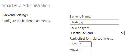

  2. From the General Settings page click the "Add New Backend" link to add your new Elasticsearch backend.
  3. Next, enter the Backend Name and corresponding information in the appropriate fields. See the following graphic.
  4. Backend type: Select ElasticBackend or ElastcBackendAws (for AWS-hosted Elastic Search service) from the drop-down list.
  5. Rank offset formula coefficients Optional.: Enter these values only if you selected the Rank Based mixing algorithm that is set in the Properties for  SSA page:
    • BOOST: Enter the boost factor.
    • OFFSET: Enter the rank offset.

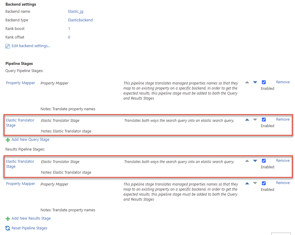

Pipeline Stages
After creating the Backend, two "Elastic translator" pipeline stages are automatically added to the pipeline categories:
  • Query Pipeline Stage
  • Result Pipeline Stage
These are backend-specific pipeline stages and do not apply to any other backends you have configured.
