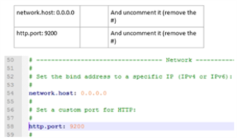

  3. Set the following properties in the YML file \config\elasticsearch.yml:
    1. network.host: 0.0.0.0
      Set the value to one of the following:
      • An IP address attached to an individual network device such as NIC.
      • This IP address must resolve to your elastic server (or a DNS which does).
      • Once set, you can only access Elastic through this network interface device.
      • 127.0.0.1 to make elastic accessible from this server only by using "localhost"
      • 0.0.0.0 to make elastic accessible from any address/IP.
    2. http.port: 9200: Leave this set at the default value of 9200
    3. discovery.type: single-node: Set this property if you are using a single server for your elastic instance.

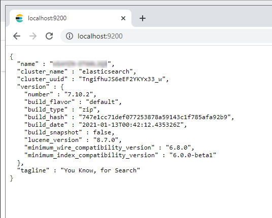

  4. Go to Windows services and start the Elastic service, which is running as a Local System service.
  5. Verify the Elastic node status by going to http://localhost:9200.
    Note: You must have an instance of Elasticsearch up and running.
    Make sure that JSON is loaded.
    See the following graphic as an example only.

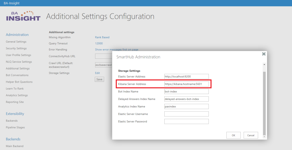

  4. Access SmartHub Administration page at https://<hostname>:<port>/_admin.
  5. Go to the Additional Settings Configuration page and replace the Kibana Server Address with the new address shown in the screenshot below:
    For more information see Encrypting communications in Kibana.
