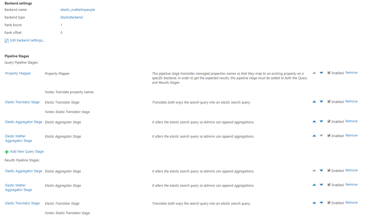

  • The Elastic Aggregator stage is a native, built-in stage that works on top of the Elastic backend.
  • The stage has to be added both as a Query and Results stage.
Pipeline Stages
  • A Results stage has to be added first on the list with pipeline stages, because it is an Elastic translator stage.
  • A Query stage has to be added last on the list with pipeline stages, after the Elastic translator stage.
Stage Parameters
  • For every search interface (every content by search and main search results) add a new set of Elastic Aggregator stages.
  • Separate the execution flow by specifying a differentResult source ID.
