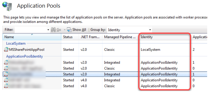

  4. Go to Application pools and find the application pool from the previous step.
  5. Find the system account used for running this application pool (Identity column).

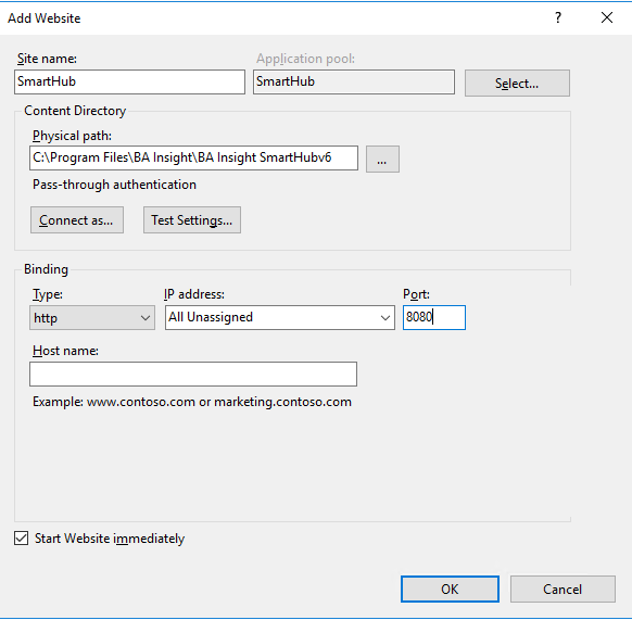

    1. Right-click <Sites> and select Add Website from the pop-up window that appears.
  3. Site name:
    1. Enter your site name.
    2. For example, enter SmartHub.
  4. Application pool: Select an Application pool account that has FULL permissions to your SmartHub installation directory and the files within it.
    1. The default AppPool account DOES NOT have the necessary permissions.
    2. See the topic How to Change Your Application Pool Identity Account below.
  5. Physical path: Enter the path to the unzipped SmartHub package as shown in the graphic above.

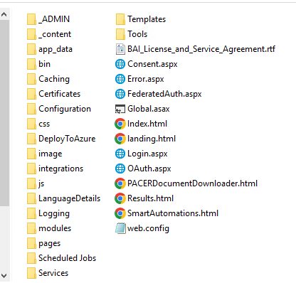

  6. If you select Content View from the bottom of your SmartHub Content site, your folder structure should resemble the structure shown below:
    1. Note: The "Configuration" folder does not appear until you have set your Authentication mode under the "Security Settings" category in the SmartHub Administration site.

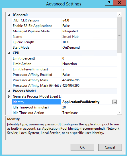

Use the following instructions to change your Application Pool Identity account.
  1. Open IIS manager if it is not already open.
  2. Click Application Pools from the left-side Connections pane.
  3. Select the Application Pool you wish to change. Note that you can sort your Application Pools by categories such as Name, Status, Identity, Applications, and so on.
  4. Right-click the Application Pools whose identity you wish to change and select the "..." button.
  5. Select the built-in account you wish to use from the drop-down menu or else click the Custom account radio button and click the Set button.
  6. Enter the credentials of the Application Pool Identity account you wish to use. Be sure to enter the account user name in the format <domain>\<name>.
